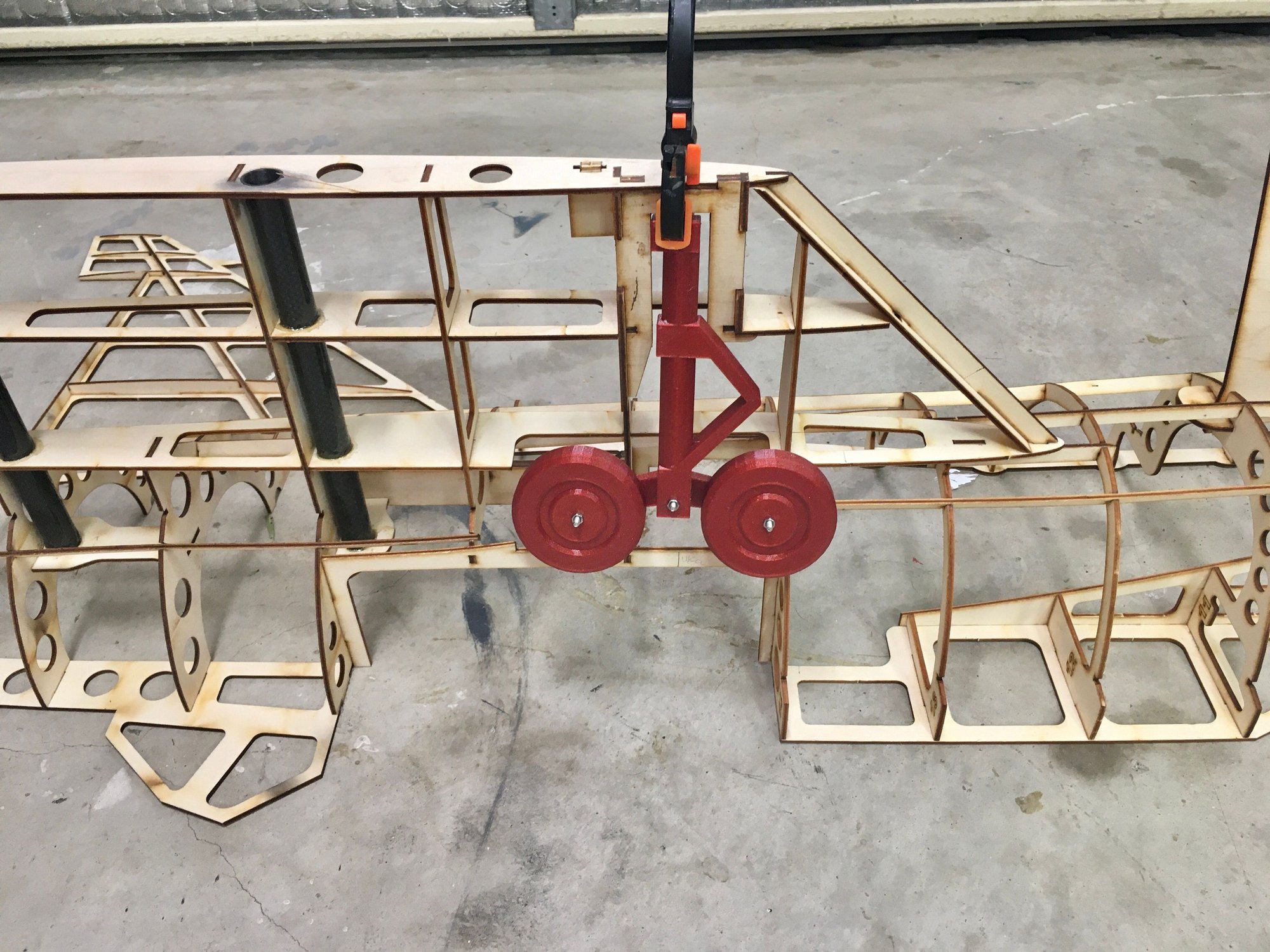

I used Ed’s initial design and 3D printed a set to try it out (much easier than Papier-mâché). The first question related to the strut lengths, to make sure the mains and nose lined up correctly so that the plane sits level on the ground. The Mains use a 65mm wheel and the Nose twin 50mm units with the final products from JP Hobby.
3D printed representations of RCcrafters inital design
Layout of the Mains and Nose units to check the relative strut lengths. All good.

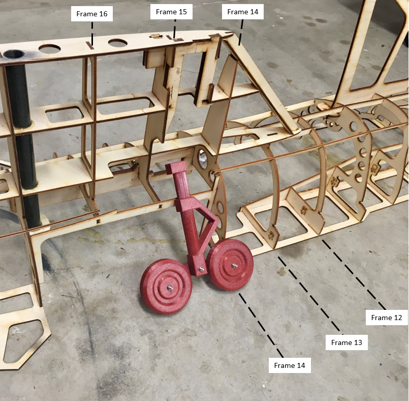

When putting the Mains up against the constructed kit, it shows the design did not accommodate the forward wheel of the mains when retracted into the fuselage. ** Custom Wings – recommend you move Frame 14 design forward to 13, and copy/past Frame 15 design to 14 (will result in extension of EDF engine access hatch by one frame too) **.
Issue with Mains retracting into Frame 14
Clash with Frame 14 - Some work with the Dremel and some custom framing & formers are required....

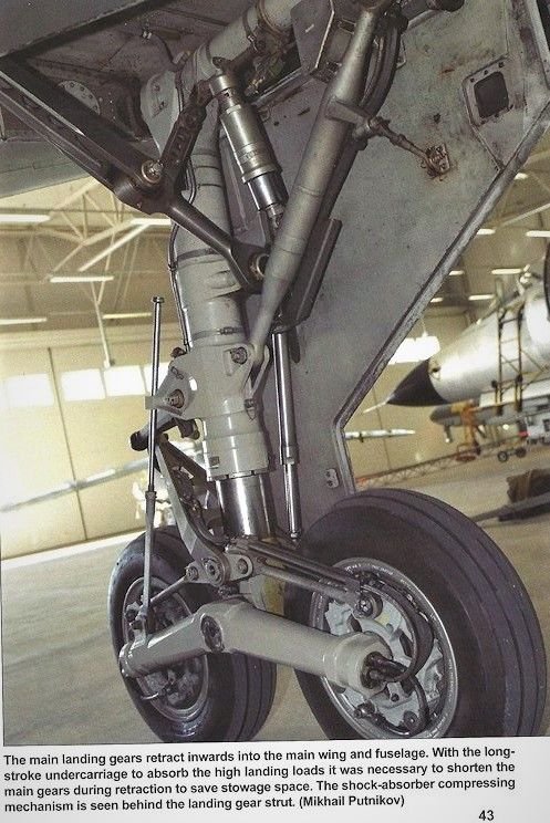

Photo from the internet showing the layout of the Mains. Note the alignment link on the front which has been replicated in the RCcrafter's design.

Because of the design of Frame 14 mentioned earlier, together with the addition of the Aft Brace to the undercarriage, the Dremel had a bit of a workout. The photos below ONLY have material removed from the original Custom Wings design, I have not added any structure at this stage. It’s purely to show the modification I did to the kit to fit it in.
There have been no issues with the RcCrafters undercarriage, it fits in the wing fine. All this rework is around accommodating the kit design around this undercarriage.
The kit structure I removed in order to fit in the undercarriage. 3D printed Mains included for reference aligned with their mounting location.
Installed RcCrafter's Viggen undercarriage. Now to build in the mounting and support structure.
