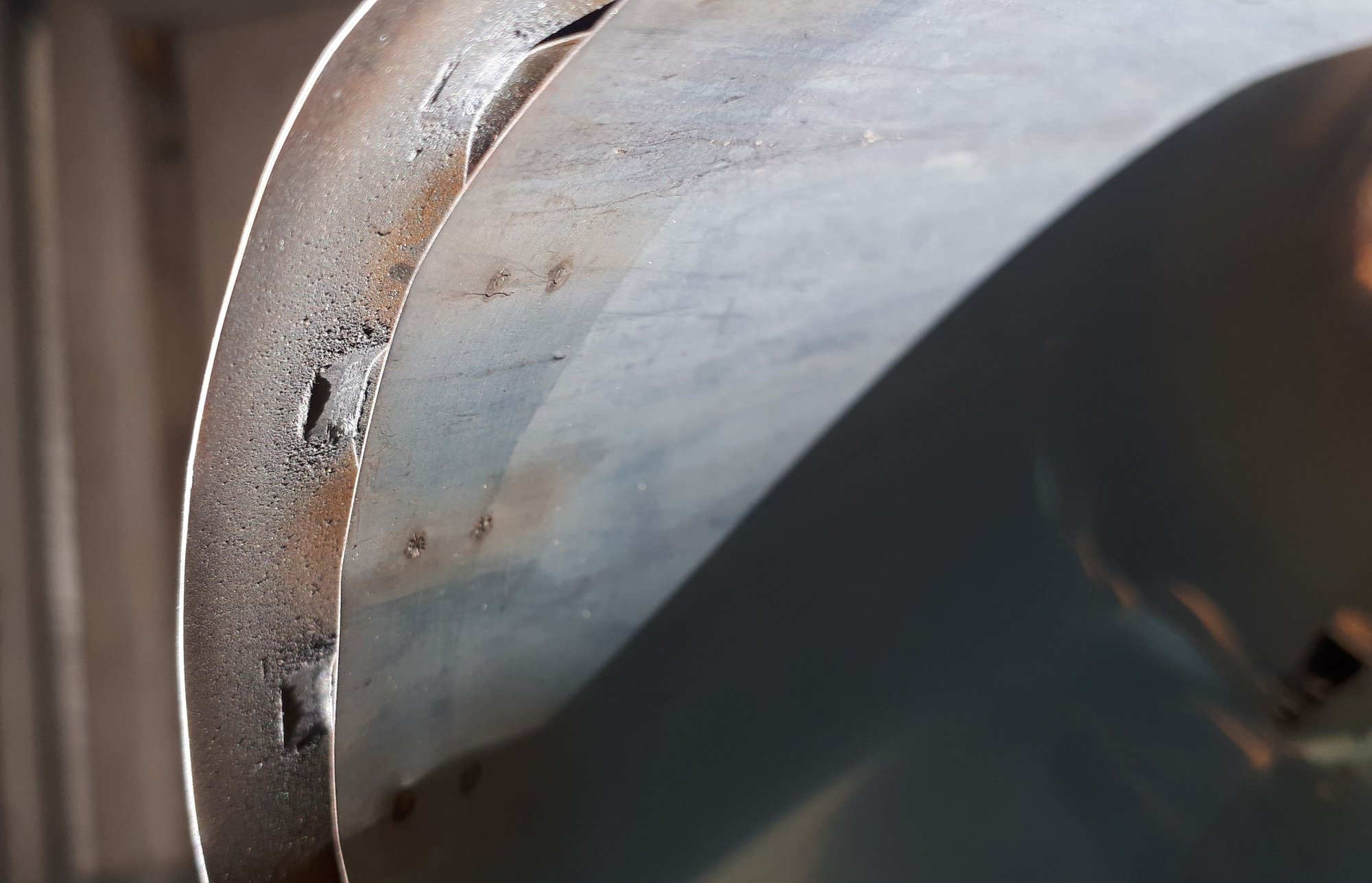

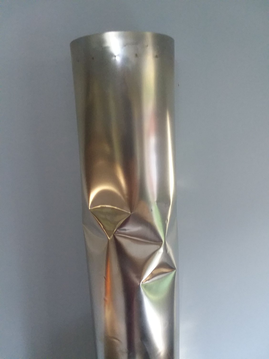

I was flying my L39 over the weekend and kept hearing this "tinging" noise. When I pulled it appart for storage, I noticed this crumpling near the end of the pipe on the outer heat shield. Never had it before with my previous plane or any other for that matter.
Crumpling at the end of the exhaust.
The inside of the pipe looks fine with no issues. Also, the airflow is pretty good around the pipe and the distance from the end of the turbine to the straight part of the pipe is 1". Does anyone have any idea what could have caused this? There are less than 10 flights on this bird.

Im not going to say its a 100% the same as a recent issue but I would bet it is. I recently had this same issue with my pipe in a new jet, the problem is the pipe is most likely welded at both ends of the outer/inner walls. This is from the the inner wall expanding from heat and since the outer wall is not free floating at one end it stretches the outer pipe and when it cools it does this.

Hi all. It does look like outer pipe is not sliding correctly. If it's welded on both end's or not I can't comment about but they need to move. Here is an example of good pipe. It finally gave away after 60 engine hours and 6 years of use. It still was not due weak pipe but loose mounting strap and engine misalignment instead. It did have plenty of broken welds and some hair cracks already.
Anyway this beeing well used one can see outer shell grinded grooves about 3mm in lenght. While taking picture it was 11C. In fight it is hundreds of degrees and it's visibly longer. This happened to have aluminium outer pipe but it makes little or no difference because of huge temp difference.
Check you pipes annually
/Jyri
That's a pretty good example. It was down pouring by the time I got home yesterday. I will try to check tonight and see if it is welded at both ends.

I recently bought a (NIB) BVM 1/6 F-16 and it had exactly this problem.
The outer pipe was welded at both ends and on the first ground run the outer pipe was pulled out from one end and wrinkled.
The pipe was utter crap. Not what you'd expect from BMV.
I got Joey (JET Pipes) to strip off the outer pipe and make it properly with a sliding fit at one end.

On my 5th start on a recently new plane the pipe did the same thing. At the time, when I heard it wrinkle, I first thought part of the turbine went down the pipe as the igniter failed on the next start. I also thought maybe the last former may have been too tight and when it expanded, it could not move. Also, I noticed when I put it together, that the outer pipe was a lot thinner than what I normally get. Mine is welded on the exhaust end too. I do not plan on using it.

You guys were correct. The pipe is welded all the way around on both ends. Therefore, not allowing the pipe to expand and attract with the heat differential. Funny thin is that some of my other jets are the same way. However, those pipes are much smaller and use a smaller size turbine.

Seems all china pipes come this way,
smaller ones (45N ) get away with it but larger crumple...
Use box cutter and few blows with a hammer and you're done...
fixed mine and flew 30ish flights without a problem...
