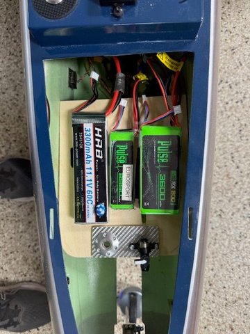

Just a little info, might help out the next person with their build. I do not have the VT Matrix and have a kingtech 130G5 in it. With the turbine battery up front on the supplied tray, the receivers batteries needed to be placed way back almost to the tank, it is a pain to get them in and
out. So I made this tray and the CG seem to be just right. This way I can get the batteries in an out much easier. I am going to paint it so it looks nice. One other thing: I cannot get full flaps with the servos arm supplied. I am going to work on that today.

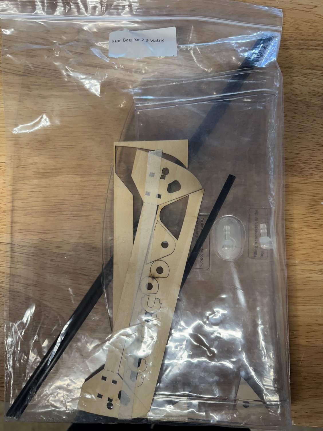

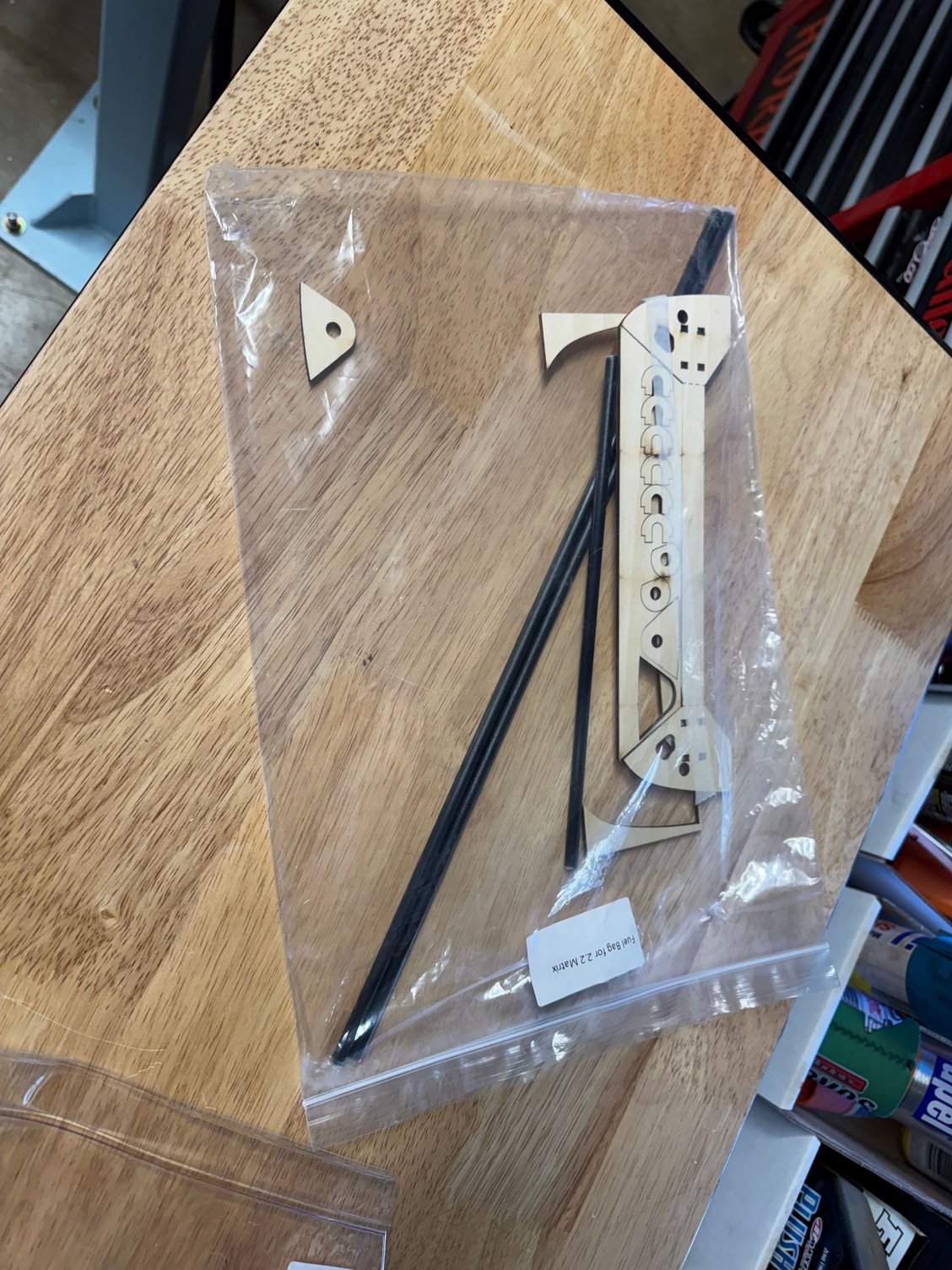

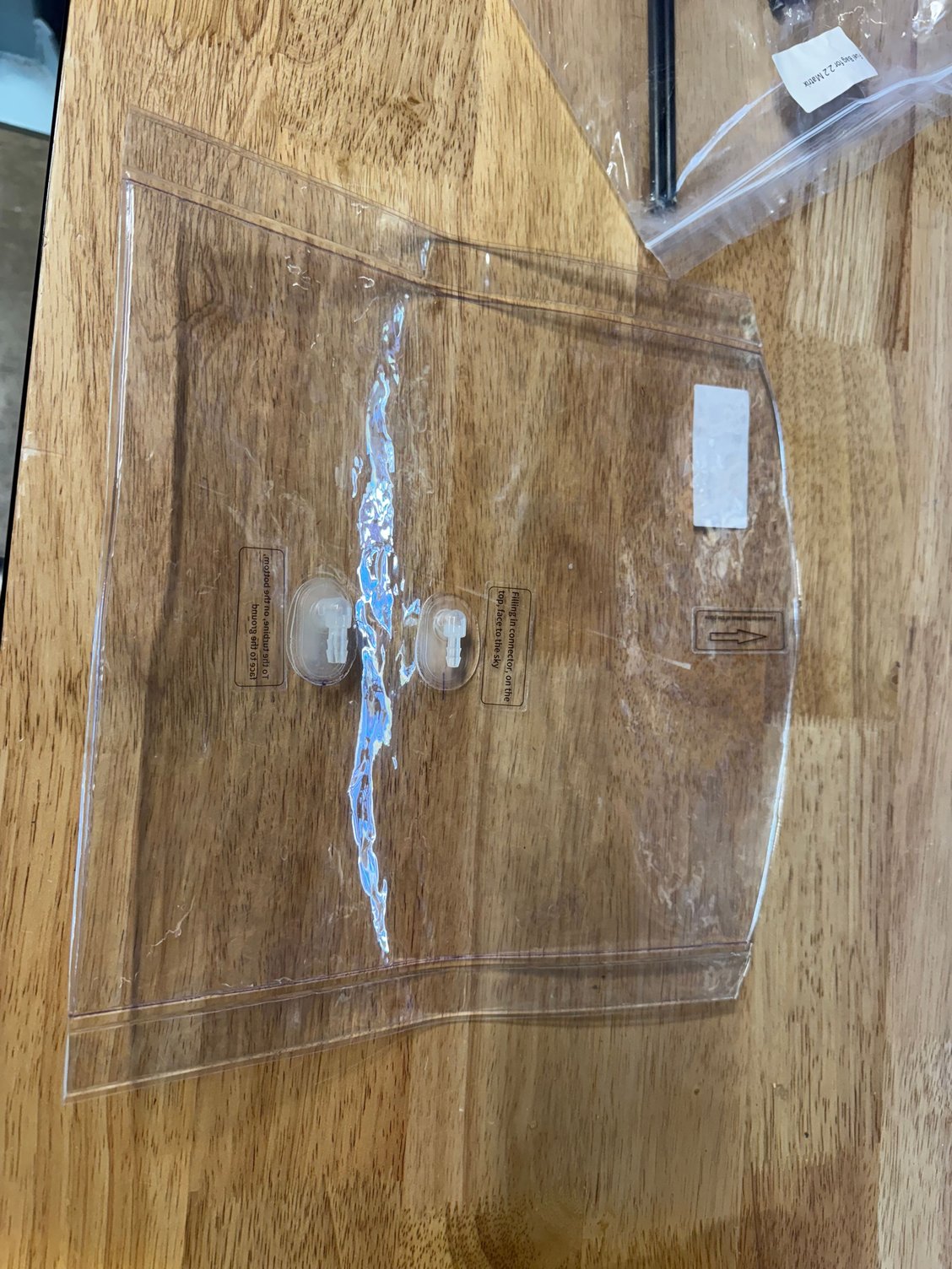

Hi.
I flew my Matrix over the weekend. What an awesome jet! It goes fast enough but it feels so good flying it slow.
I have bought the fuel bag for it. Has anyone tried this yet? I see on the Banana Hobbies web site that the new kits come with it, instead of a kevlar tank. The Pilot bag does not have a fuel pickup line in it. Pilot seems to be really interested in making good airplanes and testing their stuff before selling it. So, I kinda of trust that this thing will work.
Old 01-20-2025 | 10:35 AM
BarracudaHockey's Avatar
My Feedback: (11)
Joined: Jul 2003
Posts: 28,260
Received 443 Likes on 362 Posts
From: Jacksonville, FL
That doesn't meet the specs if you plan on using your AMA insurance
