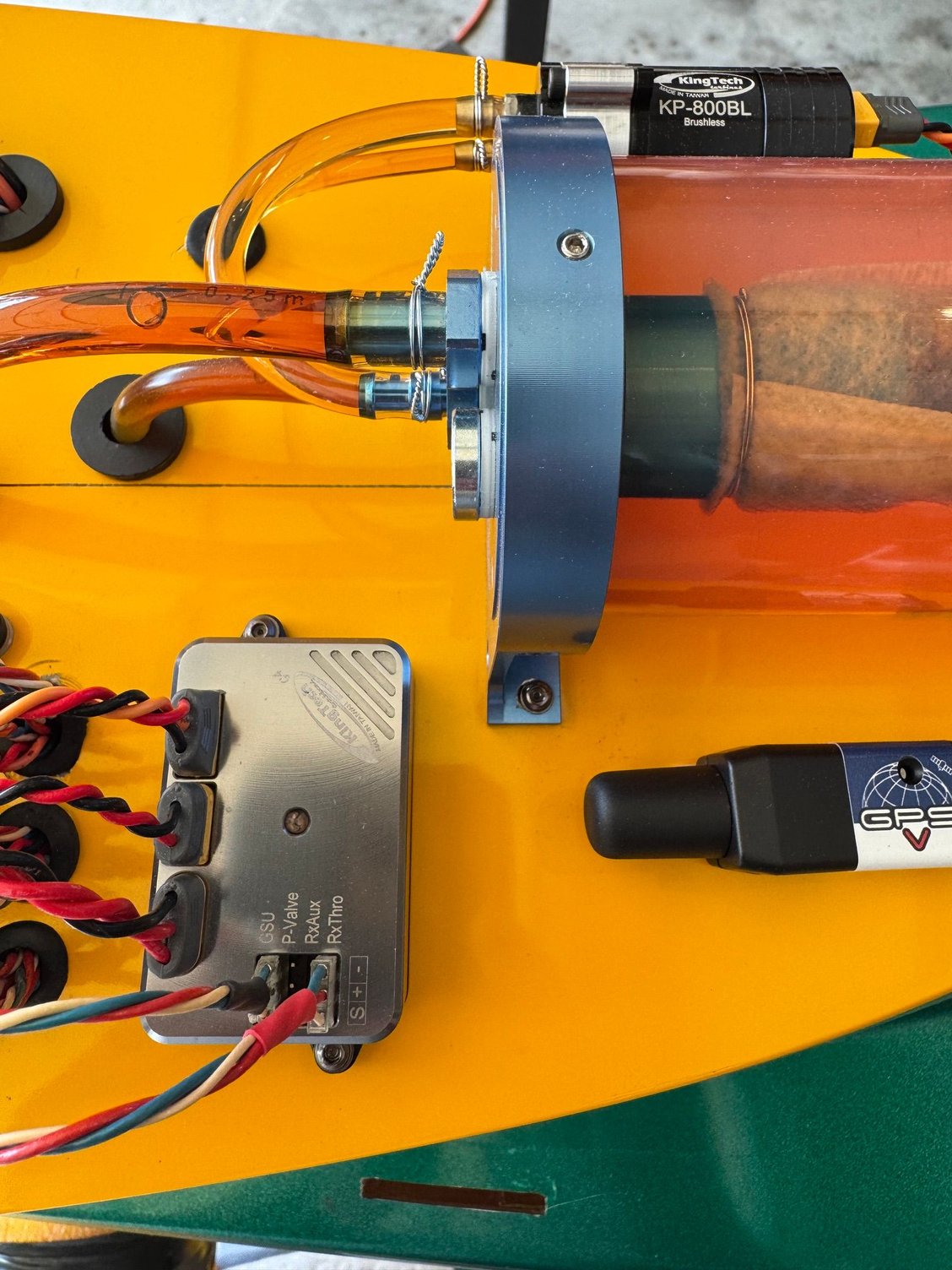

Hi,
I went to fly my Picaro for the first time. It was a previoiulsy owned airplane. I seen it fly a few times.
As I put fuel in, I immedately noticed the fuel was flooding in the fuselage. I caught it quickly but it still made a mess.

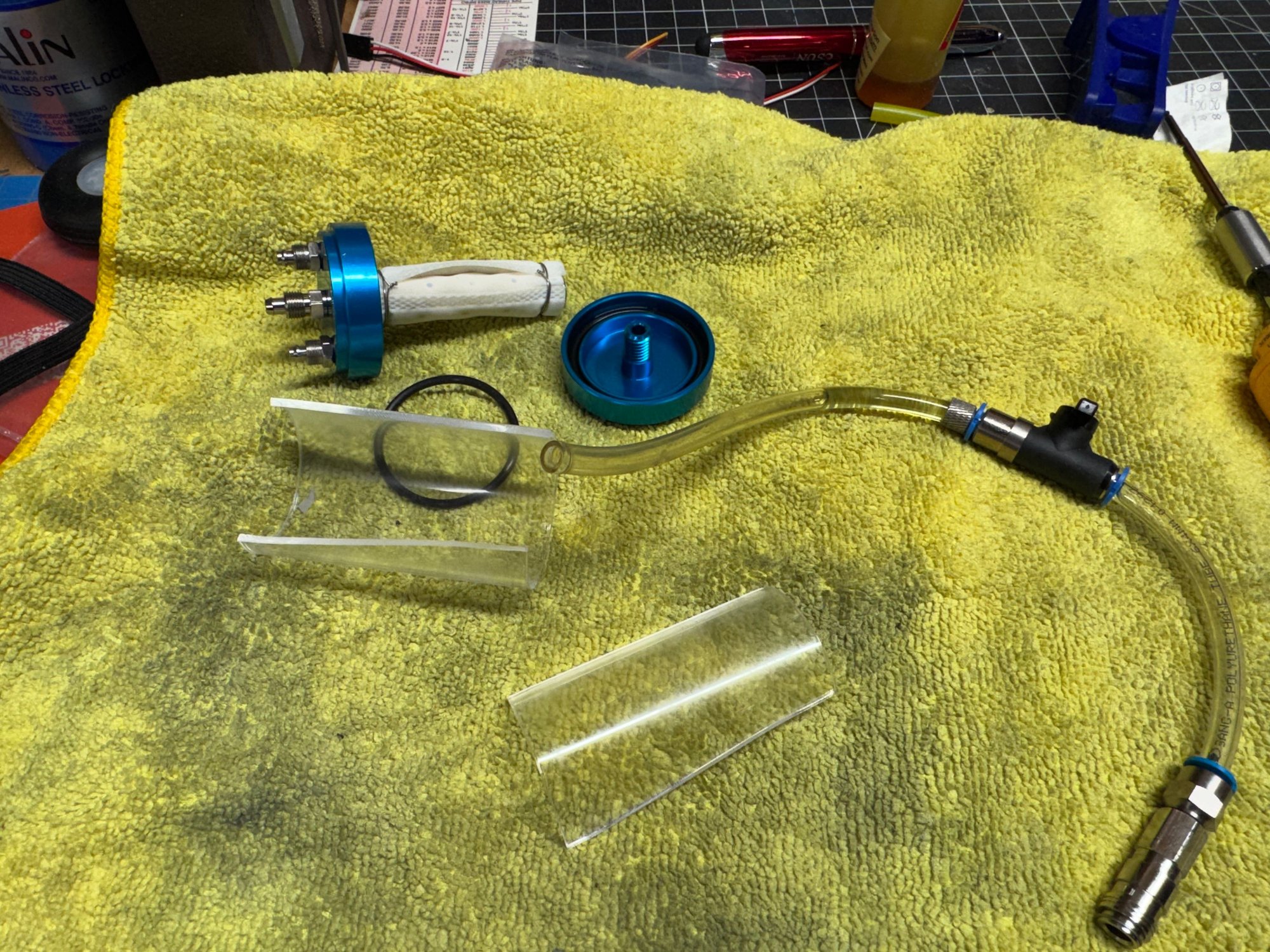

Turns out the clear tube of the UAT was cracked and split in two. I have no idea why this happened. Has anybody else experienced this?

I have been using that type of UAT (250ml) for 6 years now on two different jets flying F3S Jet aerobatics. I think they work very well. From experience, your issue possibly came from tightening down on the "grub screws" that hold both ends of the stands. By tightening down on them, they bite into the brittle plexi-glass material and disrupt the O ring seal and may have broken the clear plexi-glass material.
Other than that, you should not have any other issues with the UAT. A replacement for the broken part should be available. Try Elite AeroSport to see if they have them https://www.eliteaerosports.com/prod...43417070272726

This 100ml model has no grub screws. It was held on the 3D printed mount with nylon tie straps. The caps screw on the central part and tighten against o-rings on each end. I never messed with it. The model was fully built by the Lighter Side of RC and was a good flying aircraft when I got it.
It some how cracked on the way from my house to the field. It was perfect before I left. No fuel was leaking. Just so weird.
I used this brand of air trap before with good success. I don't want to knock it.
I order a replacement barrel from Aero Panda. I was worried about taking it apart but it was not tight at all, perhaps because it was broken.
I'm sticking with it, because its way less work to install the same and the inside of the airplane is so nice. A MAP UAT may be better, but way uglier - LOL.

I believe I discovered what happened. The fuel vent was closed and it is a really good seal. The airplane got warm inside my car, before I left for the field. The fuel system develops a surprising amount of pressure under these conditions. The pressure must have cracked the plastic tube.
So, vents should be left open.
