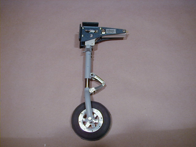

I finally got the gear and the main installation went well ( Sean , I don't think main gear doors are going to work ) but if I install the nose gear the stock way, the nose is pointed at the moon ! I see that your mounting plate is actually lowered. Do you have a different length strut than me ? My nosegear is 8.5" from the top of the mounting plate to the bottom of the wheel.

You are quite correct, the nose gear strut is too long and I have provided Don with the correct length of 4 7/8" (from top of strut to axle center). Here's the deal with mine..... First flight I had a bit tooo much flap deployed and bounced the plane twice on landing (high nose incidence didn't help). Don had a slightly shorter strut with him for the fixed gear setup so I swapped the strut with the shorter one. Second flight the landing was perfect but I must have loosened the nose gear mounting plate and on landing the nose gear mount broke loose. I glued it back in place so I could continue to fly it at Lake Whales. When I got home, I replaced the top plate by making my own, I also placed a 1/4" spacer between the gear and the front former and used the two bottom firewall mount holes to secure the gear as well since this is the direction of load applied to the gear. You can shorten the nose gear strut by cutting it to the right length and inserting a wheel collar into the top of the strut, silver solder the collar to the strut. You will also need to shorten the spring (should anyway, it's too stiff). Or....Your other option is to have Don swap the strut out for the fixed gear one which is shorter but still a tad too long.

Thanks for the reply . I had recognized the nose high attitude at Superman and was told that the gear I would receive would be shorter. Well , 2 months later I finally got the gear and it's too long. I disassembled the strut and it's as short as it can go . There's absolutely no room for adjustment. My options are not worry about it ( looks too goofy !) , make my own shorter strut or modify the nose gear bulkhead and mount the gear about an inch gear higher . I think I'll be doing the last choice. I can't think of any good reason why that won't work. Before I get to modifying can anyone think of anything I've missed ?

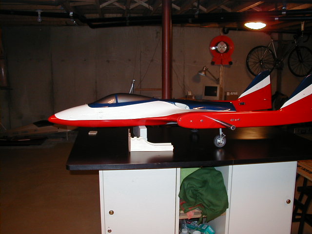

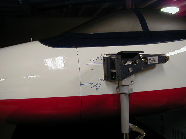

I totally understand what Todd was suggesting but it's not possible with my strut. The oleo movement is .75" and the insertion is only . 75" to begin with. The next two pics should explain it. I need to shorten the system by at least an inch to get it where I want it. The bottom blue line is the level of the gear mount in the aircraft. The top blue line is a position that I'm willing to accept but the attitude will still not be level.
Marc

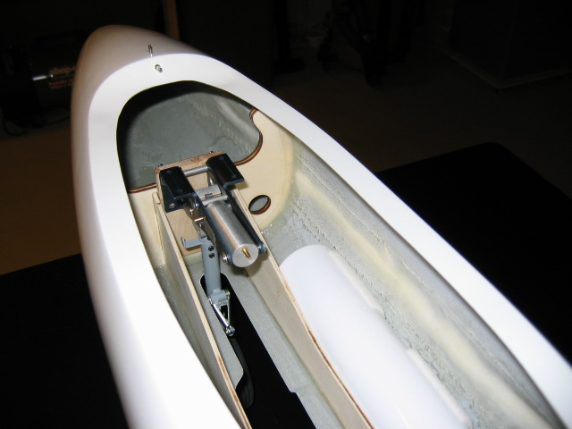

Hi Guys,
Hope you all had a good Christmas. I just got back from Santiago , Chile. Had to work but it certainly could have been worse ! Here's what I ended up doing with my nose gear. I didn't see any way to shorten my strut so I installed a 1/4" ply plate that was glued to the back of the original former. This plate just allows the gear to be firewall mounted higher up. The airplane has the correct ground attitude now. Notice that in this picture , I also have servo mounts glued to the back of the aft former. The accesory plate is held on with the servo mounting screws. A little double duty !
Marc
