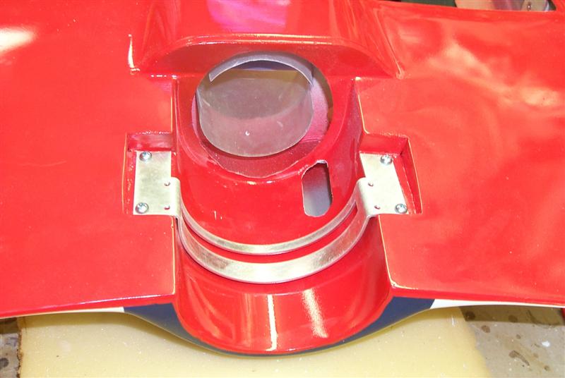

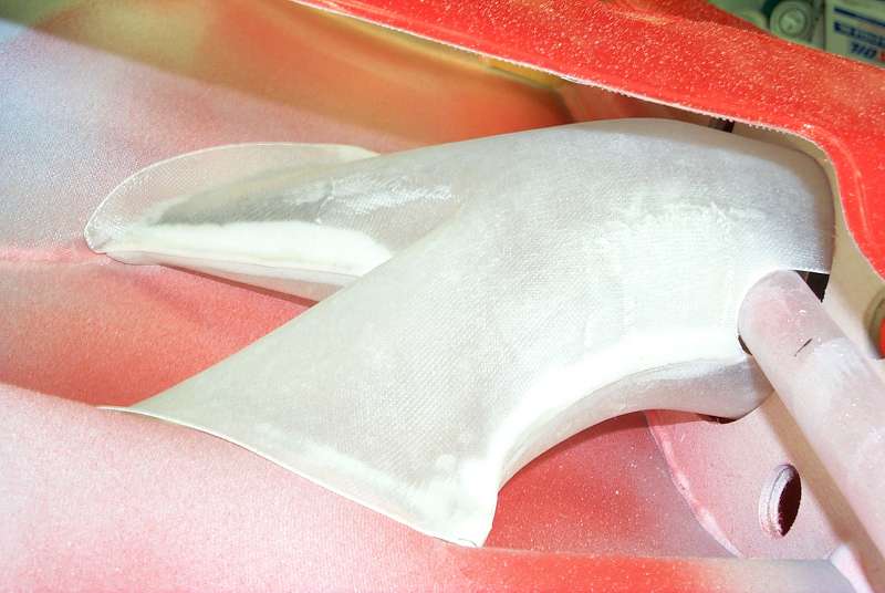

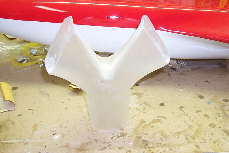

Next, I assembled the intake. The corners were missing a little glass that left an opening visible when installed. To fill the missing corners, I placed a band of masking tape around the area that that needed slight filling and from the inside, placed a bead of aeropoxy. Smoothed the aeropoxy out and let it set over night. Once set, the tape was removed and the aeropoxy shaped up with a dremel drum sander. The fit was checked and adjustments made with the dremel till it fit perfectly. I then CA'ed the intake in place followed by aeropoxy.
Todd

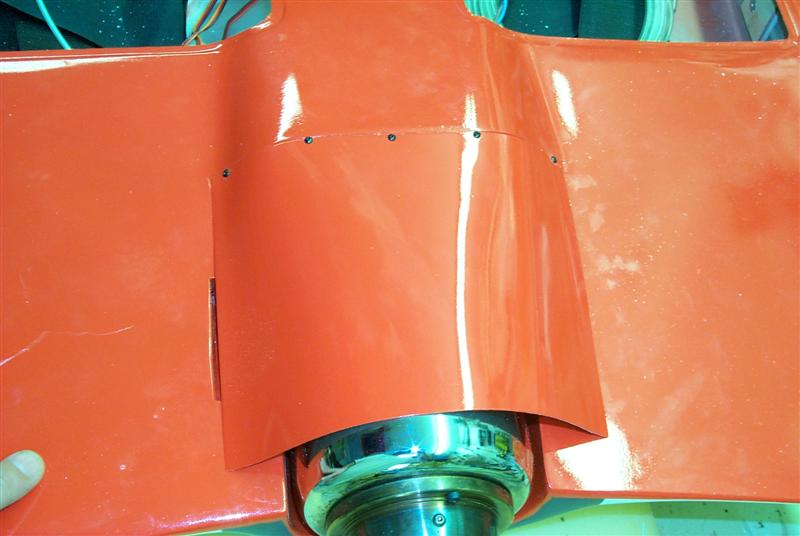

Next was the speed brake. I chose to use a BVM offset hinge here. The hinge was assembled and tacked into place. I cut the hinge holes out with a carbide cutter followed by permagrit files. With the hinge installed, I simply layed the speedbrake in place and glued it. Hinging done!

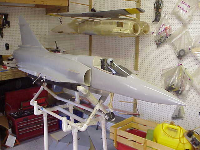

Todd, you coming out this Sunday to fly? Will the Tango be ready by then? I will have the Mirage out on Saturday to burn out any ground bugs, break in the brakes get alignment right and just taxi some then sunday if nothing fails, maiden flight.
Call you later....
Dave

lv2flyrc:
Your illustration of the brake hinge was very useful. I'm at the same stage - just finished hinging the surfaces.
Have you tried attaching the vertical fins to the fuselage yet? I was wondering whether to put a couple of blind nuts inside the fuselage, but I don't think you can get to the inside of the holes for the rear attachment screw. Maybe I could tap a thread in the plywood, but its not very thick. How are you going to do it?

Eardoc,
The blind nut for rear attachment screw on the booms can be easily installed through the servo lead hole at the fuse root. A drop of glue on the finger to hold it in place while you install it is all that is needed. I have completed the canopy, fuel tanks, all servo installation and some linkage. Should have the airframe completed tomorrow less landing gear which I should have Monday. I plan to do a nose gear door as well.... Power will be a P-80, I have not checked the mounting bracket yet but dont expect any problems using the stock JetCat mount. Tank installation had me scratching my head for a bit as there is no room to make formers to hold the tanks in place. Pictures below was my solution to securing the tanks....2" wide Velcro locks them in perfectly! I'll post more pics tomorrow...
Todd

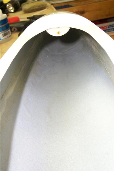

Ok guys...here's a few more shots.
Canopy has a slide in tab at the rear. The front is locked in with a pin that is installed at the nose of the plane with a nyrod to guide it.

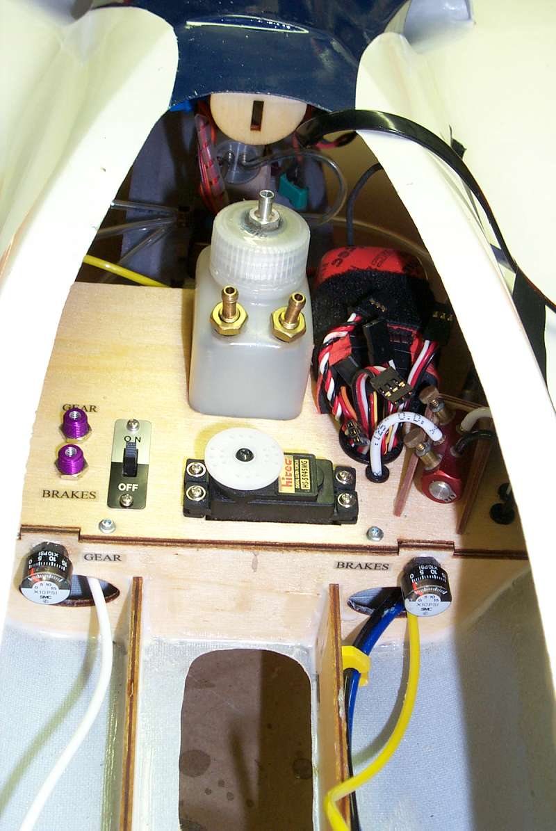

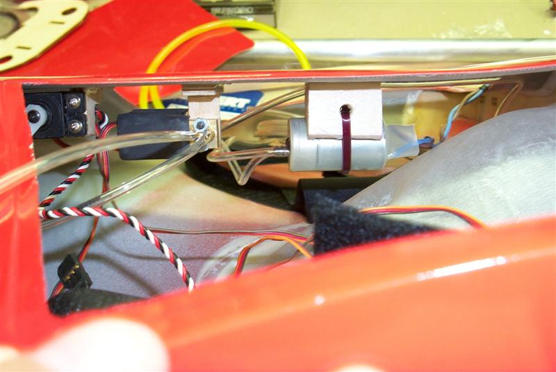

I made holders for both the fuel pump and fuel valeves and mounted them to the fuse between the tanks. ECU is directly above the pump/valves, using velcro to secure it.

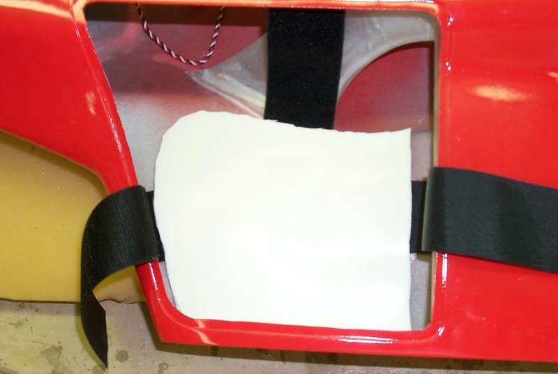

P-80 fits just fine. Had to cut a slot in the engine bay to clear the thermocouple and rpm/temp cable. Also had to cut the mounting tabs on the allum mount to fit. Servo leads are in, engine is plumbed. Just waiting on gear now and I should be able to wrap the build up in another 6 or 8 hrs.

Todd, I just turned the engine so the glow plug was on the other side, that put the
thermocouple on the bottom of the aircraft and there was no need to cut into
the bottom of the engine bay.
PLease keep the pics coming, I am gearing up my Tango now and enjoy seeing
how some one with more experience sets one up.

Those shots are of the bottom of the plane, right? Is there any protection for the turbine in the event of a gear up landing??

Nony....the fuse protects the motor....
