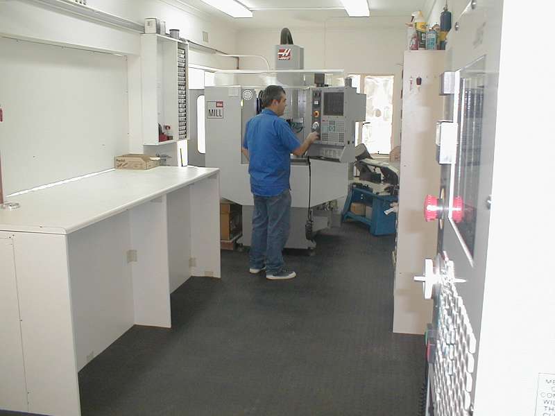

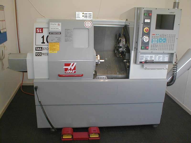

I have recently reinvested in a new CNC lathe to compliment our 4 axis CNC mill. Unfortunately an entire batch of components manufactured since February 2003 has been stolen in a recent burglary. My staff is currently working 14 hour days to catch up on the backlog. We now keep all parts in a full blown walk in safe...
The answer to your question is that we should be able to ship early December. The engines to be shipped is to the 160KS spec with 34 lbs thrust.
