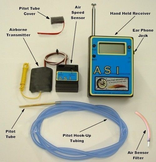

#57
My Feedback: (10)
ORIGINAL: tp777fo
I'm trying a different approach. Just ordered a Bob Fioerenze Airspeed Indicator. Downlinks the airspeed to a handheld receiver. Hope to have it in a few days. Will post more when I have something to tell.
FYI: If the Fiorenze airspeed sensor only has a pitot tube (not a combined pitot-static) and senses the static port from inside the fuselage, there is potential inaccuracies, especially given if the plane is an internal turbine where pressures fluctuate inside the fuselage.
I can agree with many as the speed limiters will not be totally accurate, but place some limit on speed, given the quality of installation.
Michael

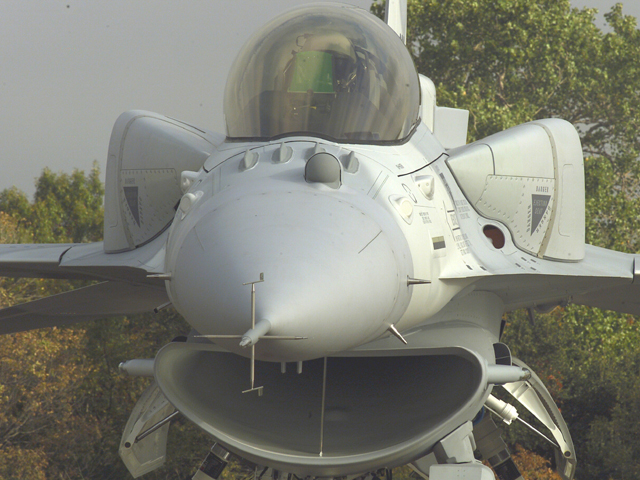

#61
AW shucks....I take it all back!
After seeing this picture, I now realize that I can have a scale jet AND get some reeeealyy awsome pitot/static air data for just about any speed limiter...
John
John

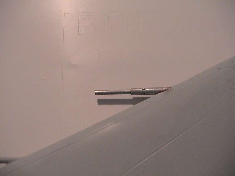

#65
My Feedback: (10)
Hi Andre,
Can you rig up a double wall Piot/Static tube, and run the reference port from your current fuse reference to the tube? It seems to work well for me.
I found a picture of the one I had on a BVM F-4. I worked well in the scale fin location. Noce the static port is located on the outside section of the double wall.
And John, I think we can agree that if either of us were AMA Presidents we would not have mandated speed limiters.

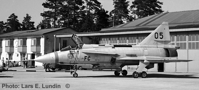

#68
Oh..I'm OK now. I just found a "configuration" for my Viggen that may work with a speed limiter. check out THAT pitot probe!
Matt' If you think THIS is bad, just try flying all the way across the country with me while discussing politics and religion in a seemingly smaller and smaller cockpit!
John

#71
Posts: 189
From: Cape TownCape, SOUTH AFRICA
Hi Matt,
The way you have it on the F4 is as good as any. The step may be a bit of a error on the double wall side maybe. On full size aircraft a static port directly on the fuselage works well if the surface ahead of the port is clean and a good boundary layer is present. In other words the pressure within the boundary layer is measured. Not an expert but it would seem that this may require calibration of some sort. The secret to good static pickup is to have smooth airflow around where the pickup is. If it is to work in all airframes without calibration the only way is with a bullet nosed pitot and four small crossholes about 2 - 2.5 of pitot diameter back. This is how our pitot is made and pretty much the same I think on the JC. Static within a fuselage is NO GOOD. On our RPV we plan on adding another static port for the differential pressure sensor. Our Hotspot testbed is easily capable of 250mph+ so speed limiting is in my opineon a good idea for the less than carefull....
Cheers
Andre Baird
Cheers
