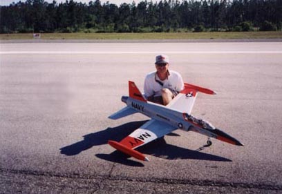

Myles,
Here's a few handy tips for painting.
Next time you try the spray can style of paints
(any brand ) Give the can a good shake until the internal ball bearing rattles freely.... Then let the can sit in a bucket/sink of hot water for 10-15 min before spraying....Try it you will be amazed at the difference, much better flow and atomization, no orange peel effect + less clogging of nozzle.
-Always use many light coats as instead of few heavy coats.
-Always keep nozzle at same distance and parallel to surface. (experiment)
-Always check compatability of paint products including primers and clear coat
-Always clear nozzle by turning spray can upside down and clearing.
I like to spray all colours in flats, either flat acrylics or enamels, then use an epoxy clear to seal. This is just my way! we all have our prefered methods.
The F20 below was sprayed with cans, then airbrush polyurethane clear coated,
Hope this helps....
Cheers - Marty
