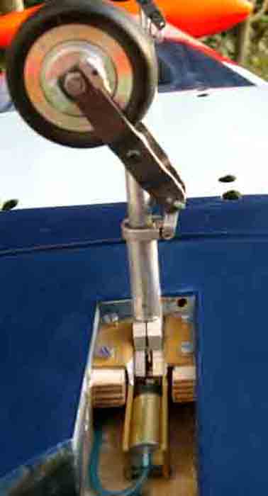

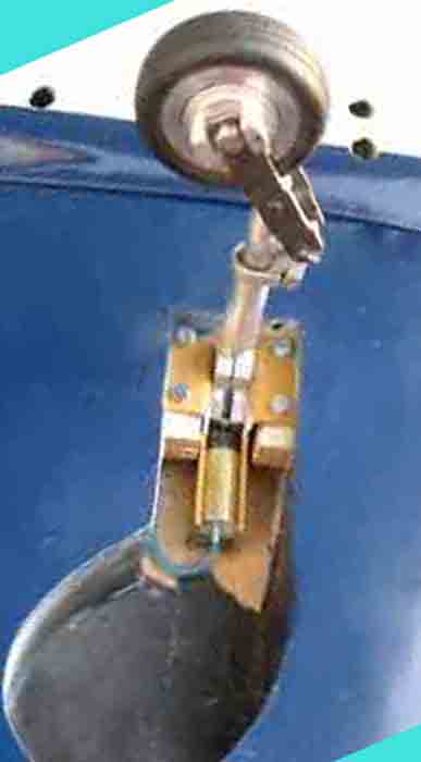

Hi there
You are right in my opinion and I enclose two shots of my solution plus a rebuild of the wing with 1/4" light ply and reinforcing the underside of the top of the wing with 2mm ply. I enclose two shots of my solution.
