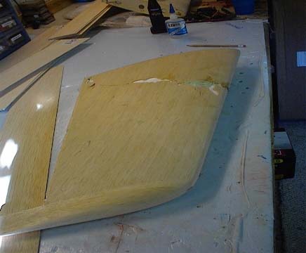

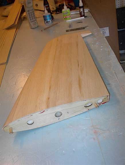

Well I thought I would post the pain staking process of repairing a composite fuse of a jet lots of work, but fun to se it come back alive...
First I access the damage and as you can see the fuse is completely broken in half on the one side and the other is shattered in the same area. The wing was broken in half throught the center and a chunk of foam was missing.

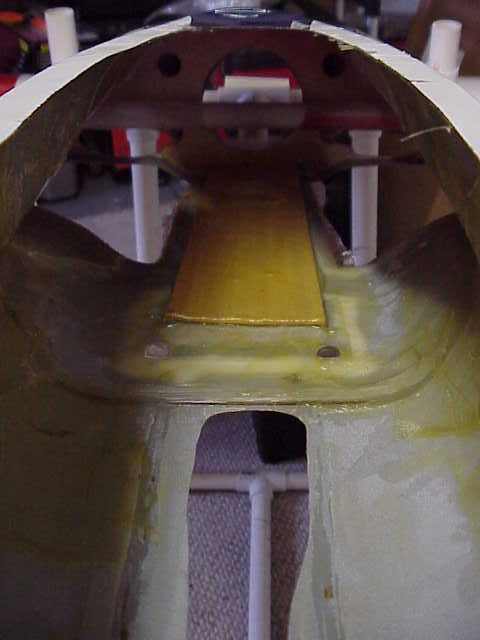

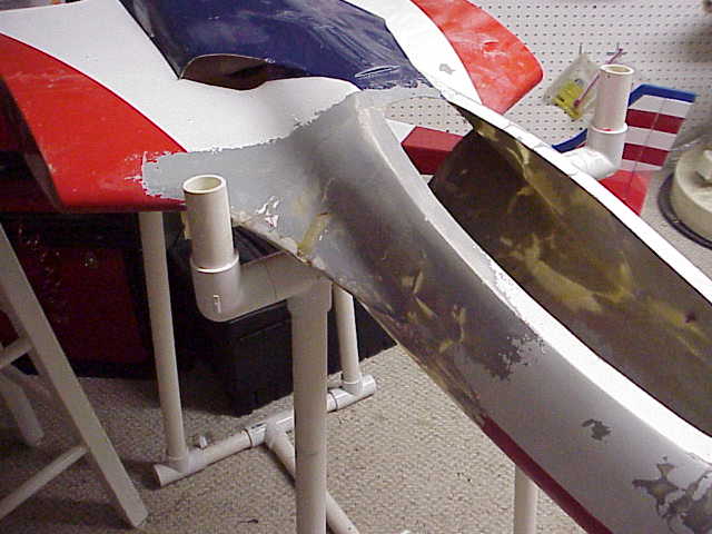

Now that see what needs to be repaired I start with the fuse. First CA all the cracks and broken joints, it don't look pretty but it gets the pieces back together. Next I cut out 6 oz glass strips and resin them over all the broken and cracked areas also I double up where needed. I aso streigthen the bottom center of the fuse as it became a real weak area so I used a piece of 1/8 balsa and glassed with 1 oz glass cloth.

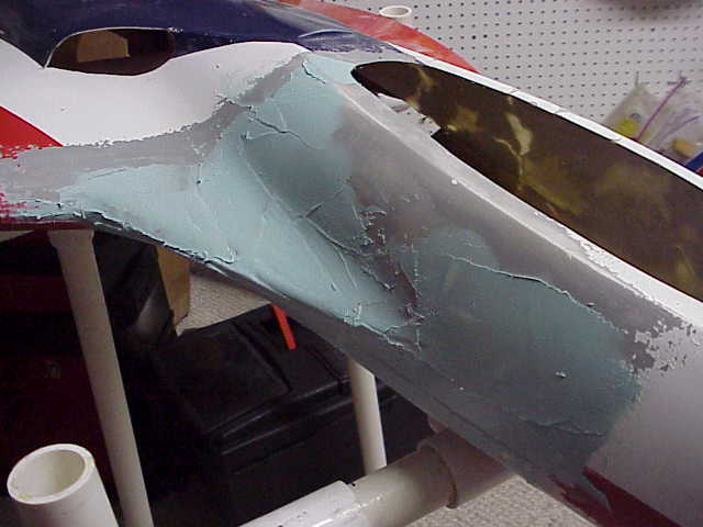

Now that it’s all glassed on the inside I brake out the mouse sander and smooth out all the cracks until there alittle smooth and not sharp protruding edges. Next I use automotive light weight bondo to fill all the cracks this is good filler and very light it in the light blue can at Walmart it has a blue hardner. To spread the bondo I have found that a deck of playing cards work great. Next strip all the paint off the fuse, this is easy just use automotive paint stripper that comes in the spray type can, I recommend this type of stipper because it sprays evenly and it only takes 3 to 5 minutes to bubble up the paint then use a plastic card to scrape it off takes very little pressure to remove the paint. Oh remmeber to do it in sections when you removing paint.

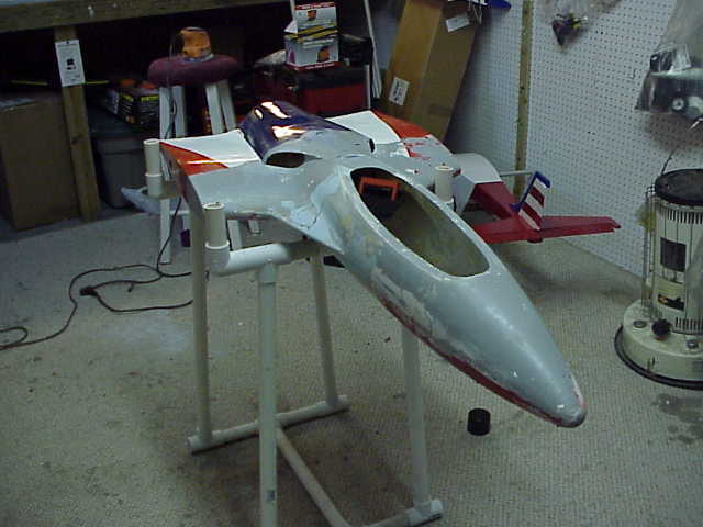

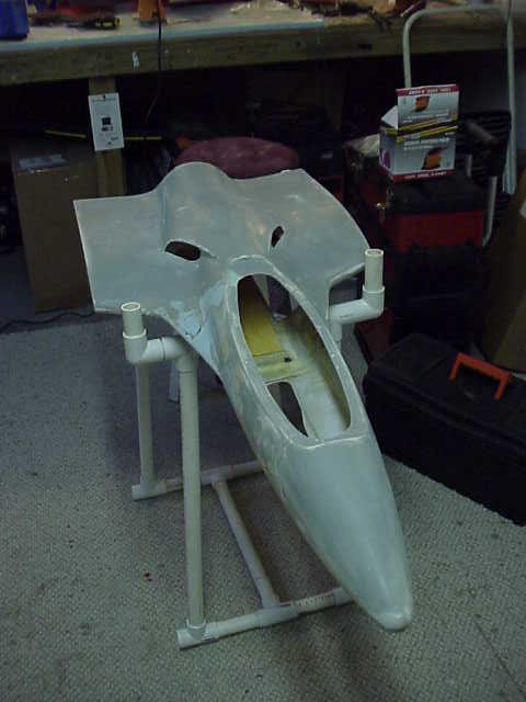

The fuse is almost ready to prime. The primer I am going to use is Dupont white filling primer this type of primer is great for filling pinholes and any other types of small cracks but I won’t prime until it warms up. So on to the wings, one side was broken in half and needs to be epoxy back together then that small chunk of foam that is missing I will fill with Spray expandable foam you can get at Wal-Mart too. When that cures will resheet the wings with 1/32 balsa and glass the wings. This will make it strong and more durable.I will repair the booms tomarrow, one boom is broken right in half... This will be tuff but I will show you a neat trick to do this.
sorry edited for spray missed type

As far as the rebuild goes, from what I understand Dave is an experienced builder and as said in another post Todd will give it a good once over. The only thing that I would have liked to have seen Dave do differently was the repair of the tears in the fiberglass. In addition to using CA, milled fiber should have been used too. You tack the tear with CA in a few places to hold everything together then you take pinches of milled fiber and work it into the tear. Then, use thin CA to permanently bond everything together. Work your way around the plane in the same manner.
This is much stronger than CA alone as the milled fiber helps to scab together the two torn parts. Also, this will help to prevent the final painted surface from cracking in the torn area as the milled fiber makes the repair stay stable. I learned this technique from Mr. BV himself...[8D]

First I choose to rebuild this jet due to it being a challenge and to show just because it’s a ARF and that has crashed is still can be brought back to life. Now I am sure that allot of you out there would second guess you building experience and just give up but, I have repaired many airframes in my past and they all have successful returned to the air, this Tango will not be any different.
There are many ways to repair a composite jet and my way is just one. The cracks seamed back very nice and the light weight bondo is just as strong as milled fiber or microballons over reinforced glass. The airframe is very strong; I have tested with lots of stress, remember the brake in the fuse is not a the wing tube joints it’s only in the upper fuse where there is very little stress in flight if it were in the wing joint area I would have used carbon fiber cloth for reinforcement. Anytime you do a rebuild you have to think light and especially if you use a 12 lb turbine. Believe me it will be structural sound before it flies again and you will never tell it was ever crashed when I finish.

Actually,
I have found a better way of filling these cracks and voids on a damaged fuse like this. Mix up some west systems epoxy thorughly, then add cabosil to the epoxy till you get a butter like consistency. Spread the cabosil/epoxy mixture over the areas you wish to fill with a playing card/credit card and let it cure for 24 hours. Once cured you can sand the areas flush. This not only fills the cracks/voids but strengthens the area as well. I have found this procedure to be stronger than the CA/Milled fiber process and much easier to sand to a feathered edge. No bondo/fillers needed....

I mix some milled fiber into some aeropoxy and smoothed it out over the crack with a credit card. It sands very well. Then glass or carbon fiber cloth on the inside of the fuse.
