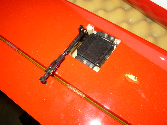

The prior posts and the pictures ont the tango have helped me out alot so I thought i'd add my experience as well. So far im really just getting started having hinged the plane and am now installing the gear/electronics. Lots of stuff but fortunately lots of room!
The first pic here is the elevator servo. Had to use bvm thin wing mounts and a 1/16" ply plate for a floor. The servo is removable. Used 440 hardware.
Scott

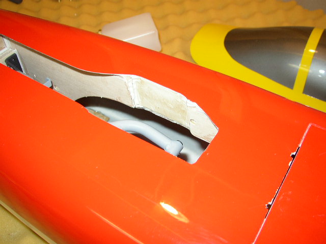

Speed brake installation. BVM offset and 440 hardware on a 9202. Mounted here there is plenty of room for the uat, propane, and deck that goes over w/ has switch, steering servo, and rx (will post more pics in a few days w/ this stuff).
You can also see the larger hardwood tab off the second former. This, with some screws/bolts, will hold the upper deck in place along with some support in the rear.
Scott

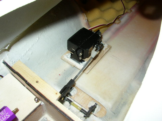

Default RE: Another tango is born....
I made two lower decks to mount gear. Here is the removable one w/ the robart retract valve and smooth stop. 2 robart small tanks will go in the nose w/ foam and the rx battery (will be sr 5 cell). The other deck is similar in size and placement but aeropoxied in.
Scott
I had to redo one of the beams to make room for the retracts.

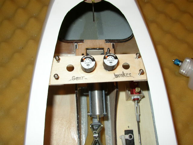

Here is the filler valve/pressure gauge mount w/o the filler valves in place.
Assembly is a bit further down the road now and once I get the camera back in the basement ill be sure to update this thread. Hope these help!
Scott
