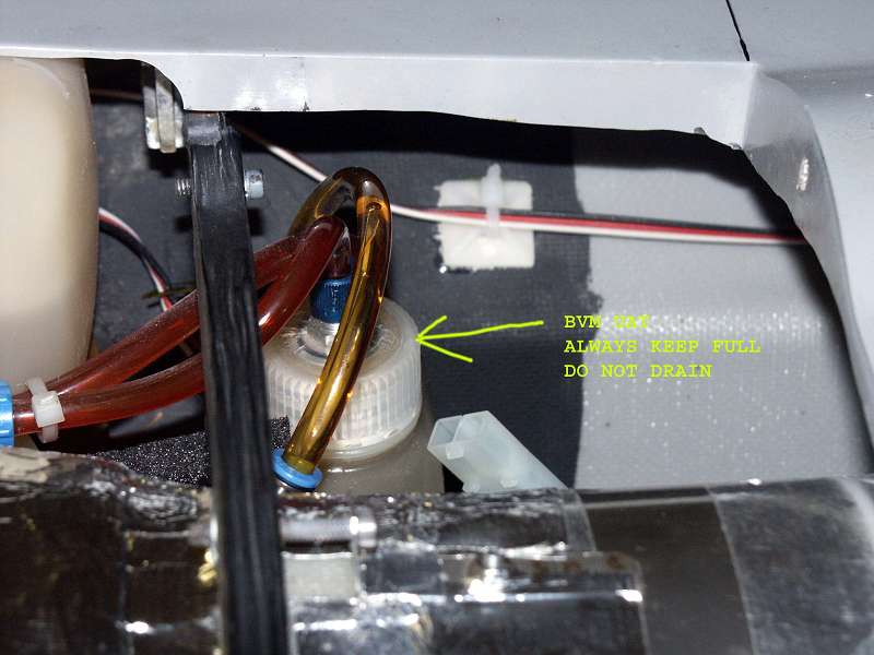

More pics
In all my future jets i am going to use the new electronic air valves for a much simpler installation
and i highly recomend the use of a FOD guard for this model especially if flying off grass

Hi Martin
CG is 29.5 inches from edge of tail cone curtesy of Johnny Hernandez who spent a lot
of time trimming out his own F15 and its spot on
I use two 6volt packs 2400ma thro a backer which drops them equally
these are located just behind the rear engine bay former one either side (see pic No2 charging plug just shows) i installed
everything and used the two batteries for final balance tanks empty gear down.
Tanks are Dubro 32 oz with BVM UAT, front tank empties first leaving mains to drop equally on CG
ensures no trim change for landing this gives me 8 minutes flying time with time for two circuits.
Elevons are massed balanced with lead shot and epoxy
elevon control servo`s are Futaba 9420 digital buggy servo`s
the rest are standard ball raced 3001 servo`s and i use a cheap £30 pounds piezo gyro on the steering servo
