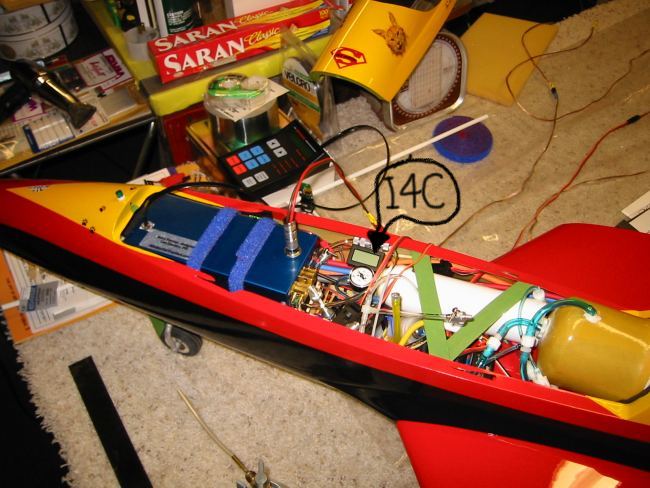

My experience tells me using the I4C unit installed on board you don't need an ammeter!! The I4C Products voltmeter does a great job. And for the I4C meter checking the ECU battery condition, Yes Nat, it can easily be wired to the ECU battery circuit. If you recall that is exactly how we found Bob's weak ECU battery at our rally! The I4C is a great tool and in my opinion should be used in all turbine installations -- you can install it in seconds, it's not expensive, and is very sensitive ----------
Lee -------
PS I have never seen anyone using an ammeter in line or other wise at the field, much less installed in a model aircraft. I'm not saying it wouldn't be better, just saying I've never have seen one used in a model ---------On the other hand I see the I4C in many installations, and it shows the slightest high current draw or low voltage situation --

Hello Todd,
This little jewel of a voltmeter is made by:
I4C Products
6924 E. 92nd
Tulsa, OK 74133-5318
Tel 918-492-9435 Fax 918-492-9375
www.i4cproducts.com
I believe you should plug one of these voltmeters into any open port on your receiver (use a Y connector if all ports are full), also after an experience at our Jet Rally, (trouble shooting a turbine problem) I think we should have one of these wired into the ECU battery supply circuit. With these two indicators visible just before hatch lock down and flight they will add an extra layer of protection for battery related failures.
Lee H. DeMary
AMA 36099
PS Yes, trust your eyes, I did get the I4C screwed around sorry. I first posted IC4 I have since corrected my posts. The correct company name is I4C Products. If you can't find one of these at your local hobby shop, and want to support a hobby shop (and a good one) which has these in stock contact Jim or Carol @ Things with Wings 6268 W. 10th St. #2 Greeley, Colorado 80634 970-352-1067 Jim has them in stock!! They come wired for JR, Futaba, Airtronics, Hitec, AirtronicsZ. If the plug type you want is not in stock the Futaba style plug can easily be trimmed to fit perfect into JR.
Note, PiC below shows one only I4C, going to add a second for the ECU circuit. It's the small rectangle full screen display (green-ish screen color) voltmeter located just above my wheel brake pressure gage / air tank----------
Lee,
Your comments on the C-Volt voltmeter are correct and many jets now have them installed for both ECU and receiver batterys. We are now testing our new Onboard Current Meter(amp meter). This instrument is the same small size as the C-Volt and will show live current continuously from turn-on to shut-down. See the exact current draw of each and then all servos by exercising them. This product will be ready for sale next month. Will be about $5 more retail than the C-Volt.
i4c Products
Rod Johnson
