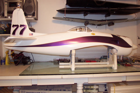

Guys, I too have been experimenting with the PPG line of clearcoats. Im doing a ziroli bearcat in Rare Bear colors from 1985(purple/white). I have done some cowlings for aerobatic birds in ppg, but never a whole airplane. So far I have applied the base coat on the fuse along with the purple stripe and Im now ready for clear coat. Am I to understand that you really reccomend thinning 200%? If this is so, how long does it take to dry with the reccomended activator? Also, say if I was mixing 1 oz of clear, how much activator/reducer would be needed in oz?
I know its not a jet but the paint is the same, any help will be appreciated.

Reducing the base cote will only make the color less opaque. Be careful reducing the clearcote as much as is indicated above. Remember when using PPG the clear is mixed 1:1 with the activator first. Then you can safely "Reduce" that mixture up to 20%. If you want to experiment with a greater reduction do so on a test piece please. Reducing will make the Clear thinner and it will sag easier, and might even get brittle-----

I have to disagree with you. I have been painting with the PPG clearcoats particularily the 2021 for several years now. Since I went to the higher reduction levels I have YET to have it sag on me. I can lay it on where it looks wet and it won't run. When you reduce it to this amount you are laying less clear on per coat. The solids in the clear are what causes it to sag not the reducer. If you have selected your reducer properly (according to the temperature range that you are painting in) then the reducer evaporates very rapidly, leaving a fantastic clear coat finish. The other thing that putting on thinner layers does for you is it makes your painted finish come out lighter. Never has gotten brittle and I just can't get it to sag.
EvanQ
Trust us on the amount of reducer and spray it on your plane. I guarntee you will be extremely happy with the results. Mix it per the instructions for the clear and catalyst then add 200 % reducer. In the case of 2021 it is 5 parts 2021 to 1 part DCX 61 then add 12 parts reducer. I use DT 885.
EvanQ
Evan, I might add that you need to lay the first coat on VERY lightly as a tack coat. Let it tack for 3 or 4 minutes, then lay on a light final coat. It will flow out to a wet look, and won't run unless you get carried away with it. In 10 minutes it will be dust free.
The base coat flows out very nicely when reduced 150% with minimal sanding before clear. What David and I are recommending works well with PPG paints and the Walcom STM gun set to the top of the green on the regulator.

I'm going to yield to your experience on this one --------- I only have used the less expensive version of PPG the Omni line. I will admit what you say makes since, and I will try higher reductions on my next bird, but I will still test it for myself first. I am stubborn as a mule, kinda like I have to see it for myself and then sometimes I still don't believe it.
Evan, no reason not to try high reduction in a test mod, then if you like what you see, shoot it for keeps.
Don't pay any attention to my reference to being brittle as that creped up in my head from the old lacquer days and adding flexers------ this new generation X'er stuff probably doesn't react negatively to more reducer------- David must know he is willing bet the farm on this one -----------
Lee------
