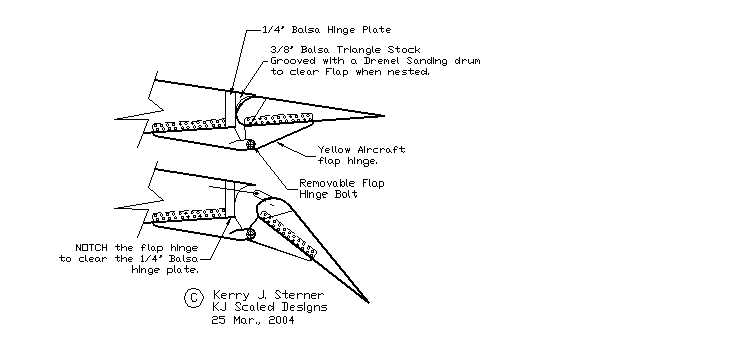

Gary,
Do you have part numbers for the Yellow flap hinges? I'm just starting my 2300 and I like the flap set up you have. I went to Yellow's web site, but couldn't find any hinges listed.
Thanks, Wayne

Hi Wayne:
The 1200 utilizes the Yellow, MEDIUM offset hinge and the 2300 uses the LARGE offset hinge.
They are sold in pairs and you will need 3 pair per aircraft.
I will have Great Northern post this mod to their web site this evening.
(www.greatnorthernmodels.com) A simplified sample skecth attached.
While the FACET flaps are very effective as designed, we are always looking to inprove our prodcuts and when I saw these flap hinges at Toledo ' 03, I decided to give them a try on our next factory ship. The use of thes hinges has enhanced the flap performace even fruther and is worth the effort and minimal cost to install.
These are very easily retrofitted to all exisitng completed ships.

Thanks, Kerry. I'm going to be at Toledo next week. Maybe Yellow Aircraft will have some for sale there.
Wayne

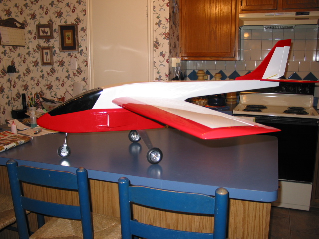

Almost finished. Hope to have this complete in a couple of weeks and test flown. Ram 500, JR 8101s on all flight controls. Sierra wheels/brakes. This one will be for sale as an RTF when complete and test flown. I just bought a big one for me.

Got the flight controls all hooked up and had to head back to Chicago for work. Hope to start getting the motor mounted next weekend, there sure is a lot of stuff to go in a little space. Have a plan but only time will tell. Still need to find a place for the brake valve and servo and the air tank. Should be a nice airplane, hopefully I can get this one sold quickly then start on my big one. See ya in Austin.

Tom, depending on where you locate the UAT, I have a couple suggestions for the brake valve and tank.
I personally have the valve and servo on FL-1 and the air tank zip-tied to the top of F-5 (towards F-4). I have also placed the servo and valve on a small plate and screwed it to the top of F-7 in the past.
