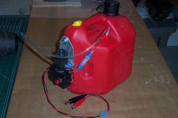

How about building your own? The one I built takes 3 minutes and 21 seconds to completely empty itself (2 1/2 gallons). It takes less than 2 minutes to fill my Bobcat XL with the associated pressure. You can substitute a blue 5 gal kero can if you want. Here is a list of parts.
Fuel Gan 2 1/2 gallons....$2.75 -----Walmart
Kavan Gas pump.............$21.95----Local Hobby Shop
On/Off switch..................$1.95------Radio Shack
Project Box for switch.....$1.79------Radio Shack
Wire and clips.................$2.50------Radio Shack
Scrap Aluminum and bolt.$1.00------Leftover stuff
Tubing.............................$2.50------Local Hobby Shop
Glass or Glow fuel fitting..$6.95-----Local Hobby Shop
Total $39.00 or so!!!
Saving $100.00 bucks doing it myself-------PRICELESS

Guys, use whatever pump you find rated for gasoline or kero for this simple project or pay the big bucks for the mail order one.
One word and one phrase: "Options and wallet depth".
