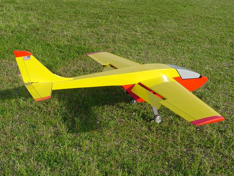

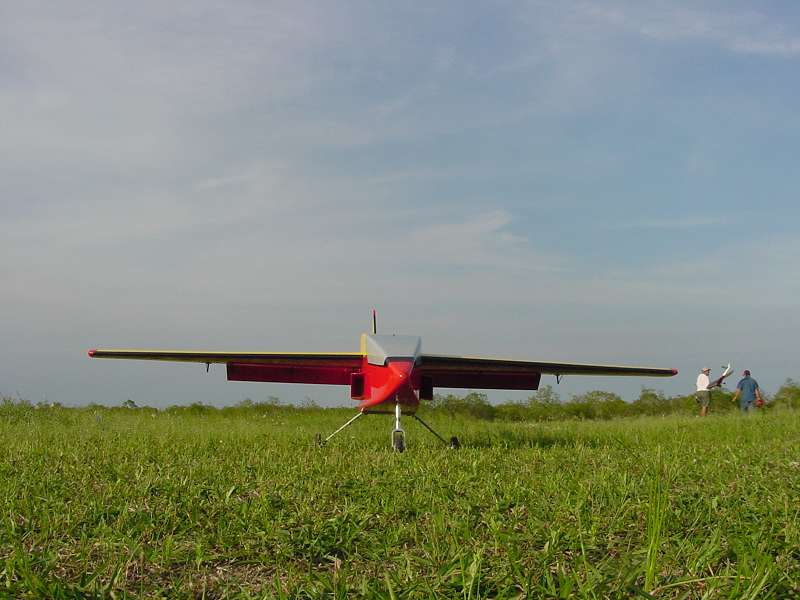

I don't know if Kerry makes a Facet beverage so I just drank a Dr.Pepper and then flew my Facet 2300 today. I bought the kit having never seen one fly, but the gamble has paid off. It is the perfect grass field jet. I knew it wouldn't need a lot of runway for take off with the P120 in it, but I was a little worried about how much runway I would need to land it. I only used about 200' to take off and about 300' to land and come to a complete stop. It's exactly what I was looking for in a jet.
Thanks to Kerry Sterner and Great Northern Models.

I used the Trim wheels and brakes recommended by Great Northern. They took a while to get as they were out of stock on them. There is another thread on RCU where someone said that the BVM Mig15 wheels and brakes are cheaper than the Trim units. You might want to check into that. The Trims work great and come with a brake valve.
My Facet weighs 20.5# dry and just over 26# wet (RTF).
The plane did pitch up with flap deployment, but it could be because I was still going a little fast when I dropped them. I had no trouble flaring for touchdown as it slowed down.

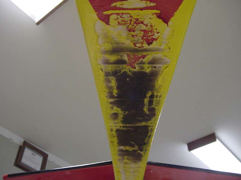

In case any of you Facet builders are wondering if you need to build the stove pipe exhaust extension for starting, check out what a wet start does to monokoted balsa:
It seems I had a data cable problem that was keeping the P120 from starting. I had a couple of aborted starts. I then replaced the cable and on the next start, well ...let's just say the crowd loved it. And I thought Monokote was a high heat film.
