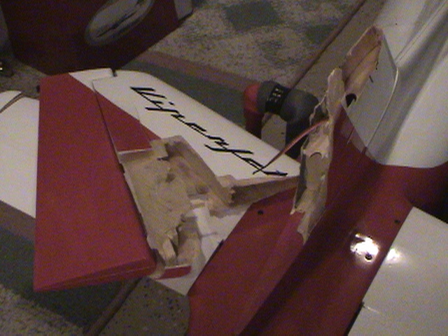

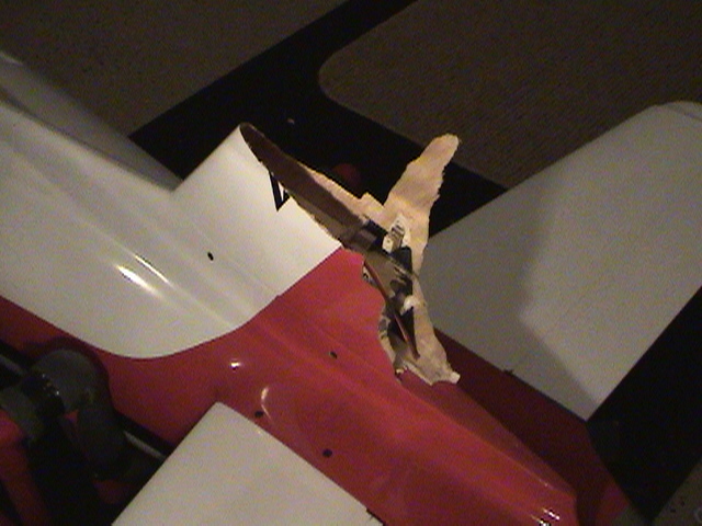

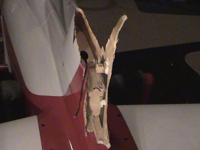

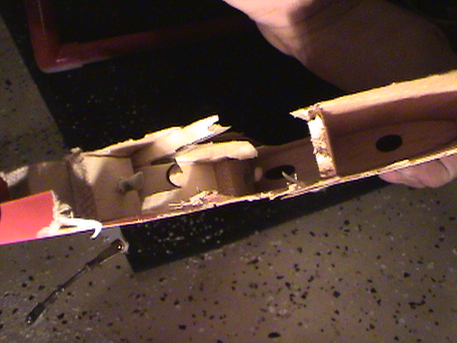

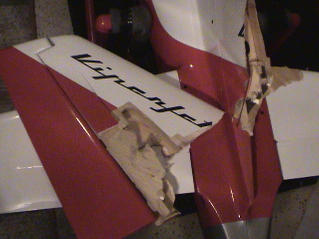

Finally got the Viperjet ready after going over it and over it for a long time. With the kind assistance of one of the most experienced pilots in turbines at the controls for the test flight all went pretty smooth until about 3 minutes into the flight the vertical stab and rudder decided to depart the airplane. Still controllable, a flapless emergency landing was made. It actually flew for two laps around the pattern that way before landing. The seperation occured in straight and level flight at a very modest cruise speed. Power never exceeding 40% except for takeoff. No inverted or crazy stuff just plain gentle flying. No signs of flutter were ever evident and no gaps between the stab and rudder to create flutter. Controlled by a $100 JR 9411 servo with lots of torque and no slop in the linkage.
Cause is not known but the stab and rudder were located after the landing and all that is in it is a balsa spar. The stab sheared just above the carbon fiber reinforcement that is used on the interior sheeting. Nothing is used above that but balsa. Further examination leads to believe the spar failed but we'll never know for sure. Just want to get the word out about a possible weak point. A phone call to Cermark ordered a new vertical stab and thought it was going to be no charge....turned out to be $95 plus the $100 servo I lost in the field somewhere that could not be found. The new one has been opened on the bottom and reinforced the spar to sheeting seams with carbon and all weak areas strengthed with thin CA. Hopefully this will prevent another incident of the same. Fortunately I had the bolt on version of the stab that I had not glued and it was easily removable. However the new ones are now designed to be glued on. So I hope it holds together this time for a long time. For those of you still building or have the stab removable I would advise strengthening the spar of the vertical stab and just making everything as strong as you can including servo mounting and linkage as well.
Thank goodness the Viperjet has winglets and tail strakes along with the portion that was left, the airplane was still controllable. Many thanks to the skill of a well known test pilot as well. Without them it probably would have gone in.

Mark,
I had look very closely to the photos.
Here is what I think what might happen.
How you mount and glue the servo? Where is the servo? Could it happen the servo plate came off during flight and take the half fin with it?
Usually the fin only can break off if you got flutter. Unlikely it will break for no reason. Even the spar are made from balsa.
The structure of the fin is seal balsa skin composite. That is strong enough.
I had test the model over the speed limit and pull until it break. The stabs and verticle fin stay in one piece when I pick the salvage.
Ehab plane pancake hard to the ground and tumble 200ft away. The stabs and verticle end up with some scracthed. No structure damage at all.
But I do got other two customer reported to me that they got flutter with they verticle fin.
After they landed and find the flutter cause by the servo stripping gear. The servo they using is not metal gear.
Stripping servo gear can cause by few things. Overdrive the servos, bump servo during transport and sloppy installation also cause flutter until the servo gear give up.

Tam,
Thanks, no harm intended. I am definately not trying to hurt your business as the next one will be from you. New colored Viperjet or whatever else. I just didn't want anyone else to encounter the same problem and lose theirs.
Thanks for the offer on the stab but I already have the new one intalled.

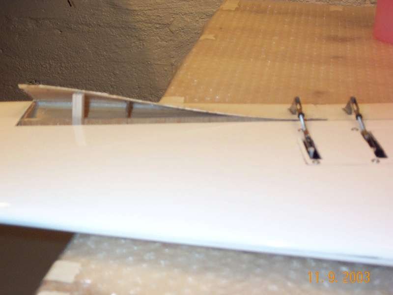

On the broken one the rudder servo was mounted in the stab using the plywood blocks with the kit using hysol to the interior of the stab to the opposite fully sheeted side. I have heard the stories of having it mounted to the hatch. This was not the case. The servo is long gone out in the pasture. I looked for two hours. Every piece of donkey dung looks like a servo case!
Again I do not know what the cause was, just a few things to look at when assembling to make sure it is good and strong.
It may have been my error or maybe it was not. I don't mean to point fingers or place blame.
I am not starting rumours and do not have that intent. I just hope it doesn't happen to anyone else. That is the whole intention of the thread. Let others learn from my misfortune.

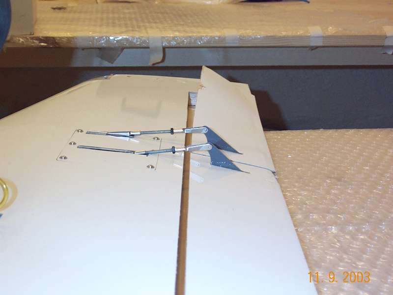

The question about the servo location is extremely important.
If by any chance you mounted the servo on the hatch cover, there is the answer for the problem. The stabilizer skin is too thick to be held in place by 4 screws and at the same time holding a servo.
To mount the rudder servo, I glued a plywood plate of 1/8", about the size of the servo and provided with 2 blind nuts to hold the aluminum servo's mount...
A few weeks ago I tried to do a few knife edge with my Viper at full throttle and the vertical fin remained there....

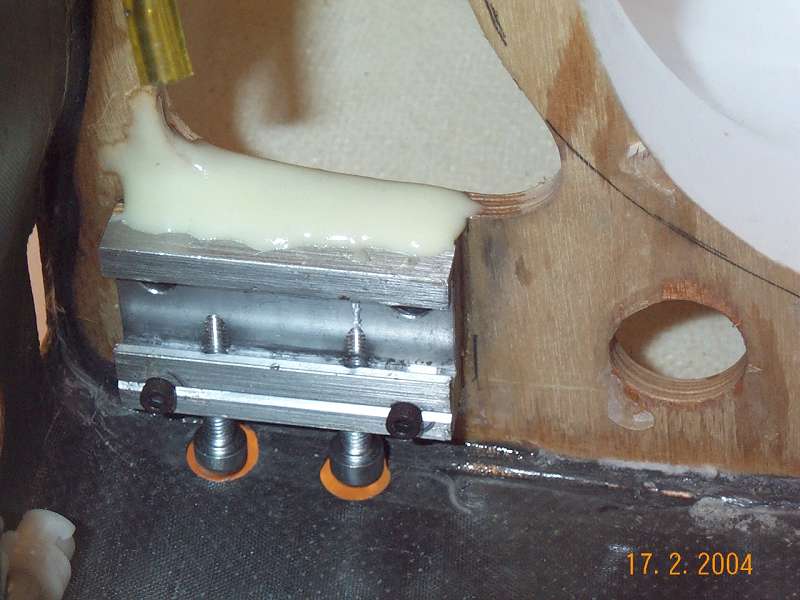

I too was a nanometer away from loosing mine on the maiden when it ripped LE of a aileron open in flight. Later it de-laminated one aileron and the metal mounting blocks for the wings got loose from the former in the fuse. There has been far to many *incidents* with the Viper by now. Too bad, because it is such a beautiful plane.
Would I buy it again....? -H*** no![&o]
[quote]ORIGINAL: SAP_2000
[ the metal mounting blocks for the wings got loose from the former in the fuse.
Did you check and tight this block before install?
Even is an ARF'S. It still need some experience to assemble. Check thru everything before install.
That why all my ARF'S kit I built never fail inflight.
