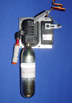

As for blowing down the gear, Paul Hopkins, one of the best installers around, has done a couple of planes with backup air......simple system that taps off the separate brake air tank that most of us use......just put the gear swithch down, then momentarily transfer air supply from the brake tank....gear comes down, switch back, and usually have enough air left to hit the brakes.....I had one of his F-15's with that system....worked slick....
Tom
