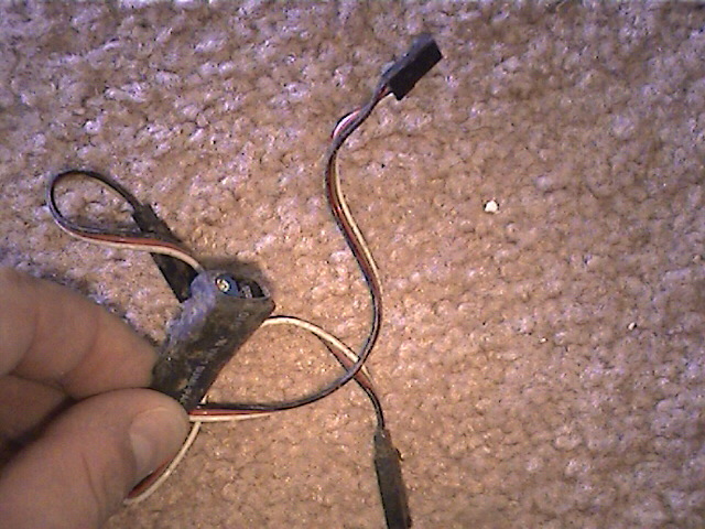

You guys aren't talking about the Matchbox right? The ones you guys are talking about are the ones that look like a y harness right?
Old 08-16-2004 | 05:22 PM
KFalcon's Avatar
My Feedback: (18)
Posts: 3,511
From: Bakersfield, CA
Default RE: reversed 8411
I have used ones like this for my less "expensive" jets. It reverses one servo and controls the center point. I never had a problem with them but looking back on it it wasn't the smartest move. I don't think it will be a big deal on something like the steering. You can actually adjust the steering center before each flight if needed, HHMMM.
seanreit's Avatar
My Feedback: (60)
Posts: 7,434
Received 7 Likes on 3 Posts
From: Cedar Park, TX
Kenny, your setup is ok and correct. We're talking about these little 10 buck micky mouse wired reversers.
Matchbox's are ok. Your heart can stop beating 200 times per minute LOL

Sean, I wasn't referring to a specific jet application, but people are using them on big proppers and have no trouble using them at all. I don't like them for even the crappiest thing. (Again, just my preference and experience.) The one I'm familiar with is the Expert brand.
Kenny, a Matchbox is the way to go if you're not going to get a "reversed" servo. Sean's suggestion of crossing the steering wires will work also if you can do it.
