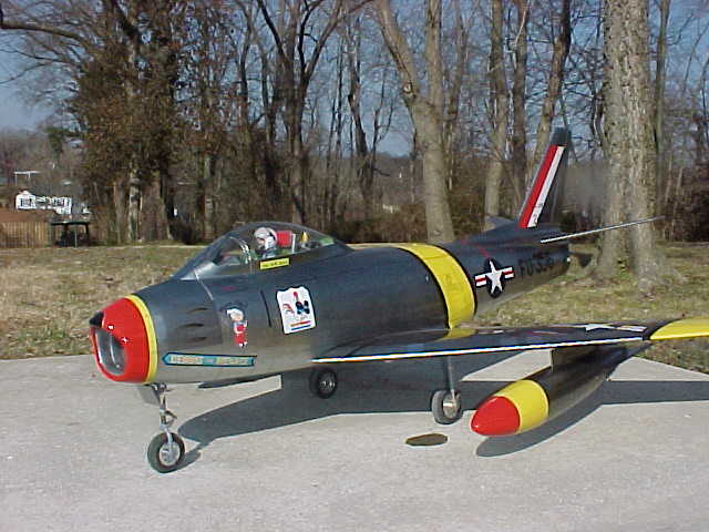

Old 08-16-2004 | 10:05 PM
Posts: 530
From: NASHVILLE, TN
Default RE: BVM F-86 conversion
Pete, I've been flying an older F86 with my AMT 180( 18# tuned down to 14#).A bit onthe heavy side but still a great flying jet. Hoping to sell the airframe soon and move on t the bigger F86. Here's a pic . Scott

Old 08-17-2004 | 10:00 AM
Posts: 694
From: Prior Lake, MN
Great looking airplane Scott.
Thanks for the reply.
