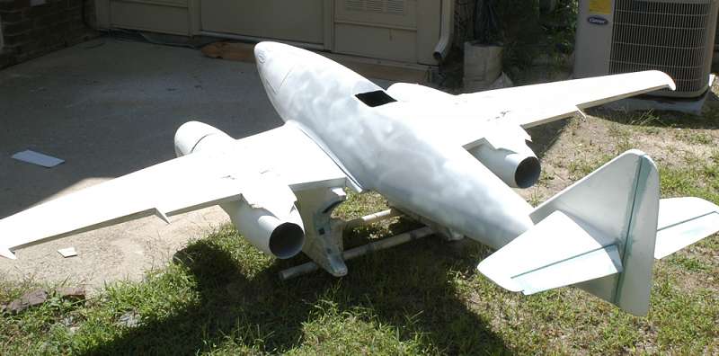

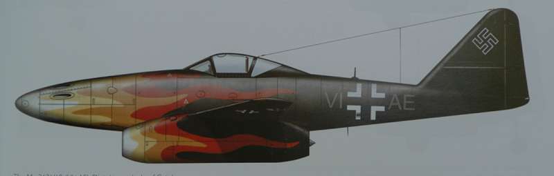

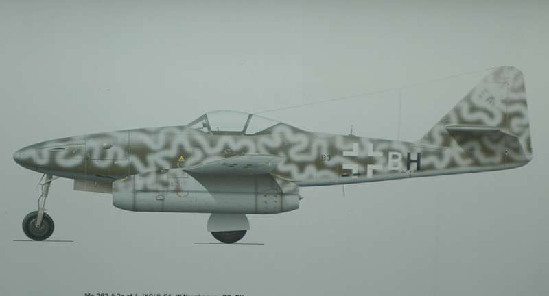

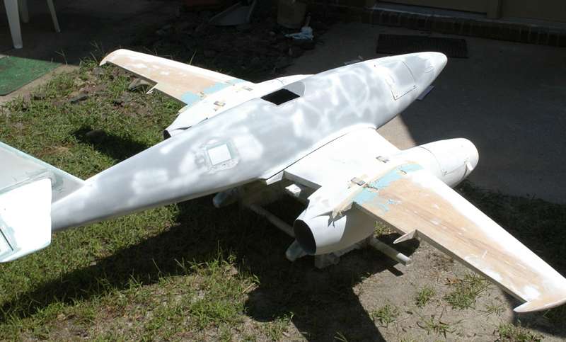

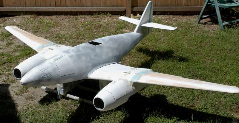

Me 262 (#2)
Jet Cat P-70 powered, 150 ozs.of fuel, shooting for a weight of 50 pounds wet.( about 2 pounds lighter that the last,with more go juice(fuel) )
Need some suggestions on a paint scheme. Watson Whizzers,(Nazi)fighter ,bomber,photo etc

how 'bout painting it Y I P P E E style?
what?
looks good Joe

How about page 600 in the ME-262 volume three book??

Looks good! It will be ready for Mesa right?
I remember reading about it but I cant remember what happened to the first one. Was it radio hit?
Can't wait to see it fly.
What are the specs on it?

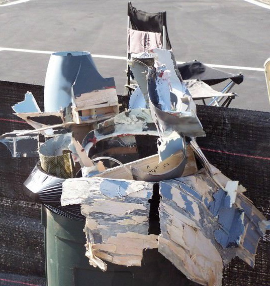

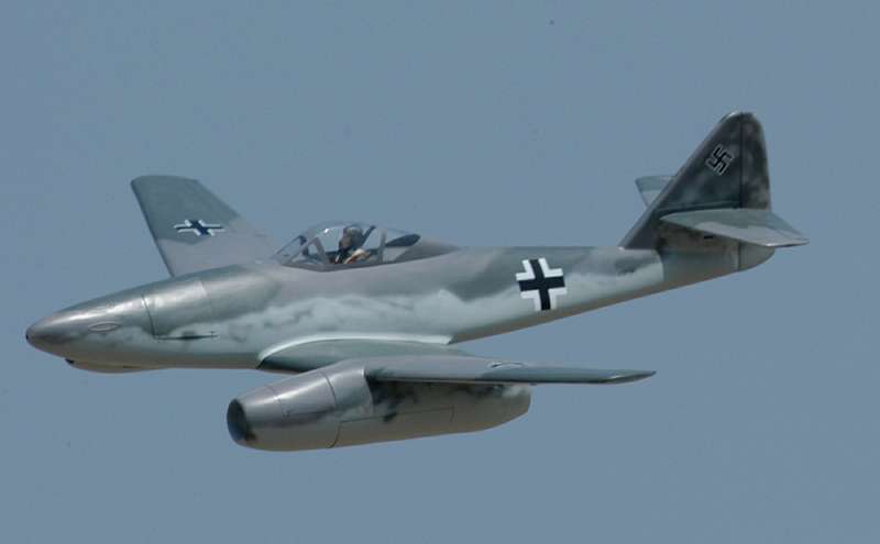

Kenny. Lost the outer left wing ,centering pin &rib failure (chicken /egg)also a failure of a super glue joint .ALWAYS make a mechanical joint if possible along with glue. Yes It will be in Mesa
It's a 1/4.5 scale? ws is 106 " Robart 152 mains & 158 nose, brakes . JR radio
Buck..... I figured you would lean toward "Flames" ..
Vin ...I like it. think the "squizze"pattern would be on the upper wing or solid?

Man that sucks!
Glad to see you were right on another! Can't wait to see it in Mesa!
Where the motors salvaged from the first one?

<<think the "squizze"pattern would be on the upper wing or solid?>>
There are some good shots also on page 601, looks like the patten is on all the upper surfaces.
I've seen plastic models of this scheme done before, FWIW, and they had the same pattern all over the upper surface of the wings as well.

Joe
those flames do look pretty cool.
how 'bout an all red one?? I think that would look sharp.

Yo Buck
RED.... "NOLO drone" birds are painted that way.....next you'll want a F 16 in those colors...

Hey Uncle Joe - Great job, can't wait to see the next one... I was in shock watching the last flight of your last one at BITW.
