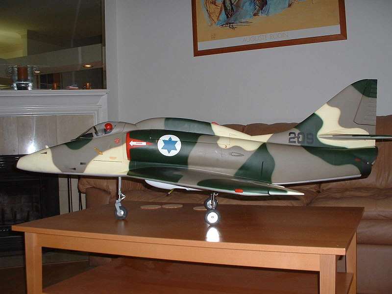

Old 08-27-2004 | 07:27 PM
AFTERBURNER1's Avatar
My Feedback: (80)
Joined: Jun 2003
Posts: 4,434
From: Anaheim Hills, CA
Default RE: Servos A4
I don't know why yours would be a little bumpy. I have the ARF camo version and it hauls *** with the J-50 SUPERBEE. Mine flys like it is on rails.. Landings are a little quick though..
DA
