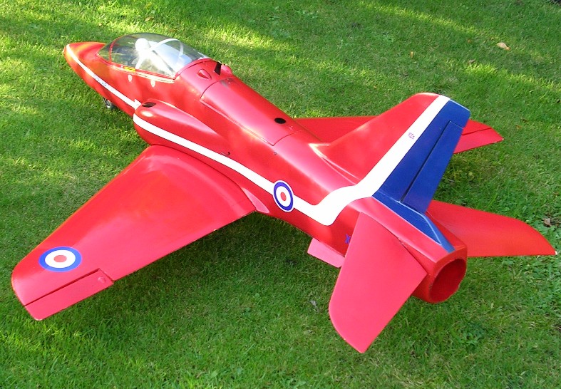

decals make all the difference.

The model is now all kitted up and ready to fly. I've installed a 20oz fuel tank.
AUW will be 11.1lbs (ouch?)
I'm using the OS46VX with Thorjet 45 7blade fan unit, with JMP Pipe. Can anyone offer any thrust specs with this combo?
Am I looking at a well/averagely well/poorly powered model.
Also, if anyone can explain what good power to weight ratios are, i would appreciate it.

Power to weight for ducted fans was always to try and get as close to 1:1 as possible... less meant loss of performance in some manoeuvres especially the vertical. Having said that, I've seen Avonds Eagles weighing 15/16lbs leap off the deck with an OS91/Ramtec pumping out 12lbs static. How long's your strip Dave?
Just one small observation.... your photo shows the models sitting a bit "nose down", that won't help rotation

Our strip is probably 200/300meters. Yes I have also noticed the "nose down" attitude; will probably put a larger nose wheel on, this will also help it get up to speed.
