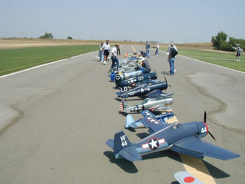

Hi Sean:
Tires and wheels on the way.
Our runway is 680 asphalt with grass.
Dave

Default RE: Runway
Hi Kqutob:
She is 75ft wide
Dave
