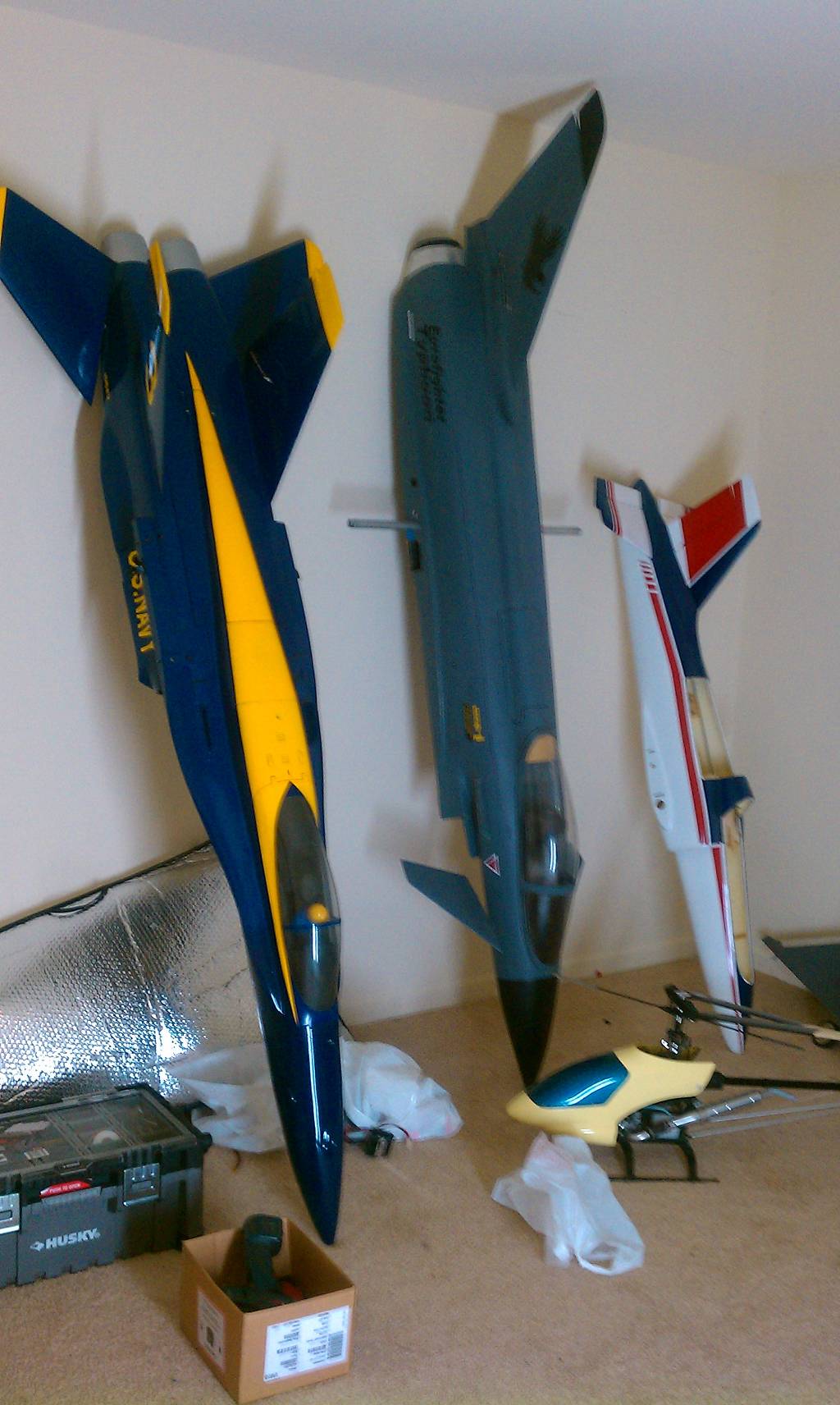

I personally pefer the SM F-18C the landing is better but you will be fine . Wow can't believe its almost six yrs since i bought my blue angle .
Wait almost forgot : Just my Opinion

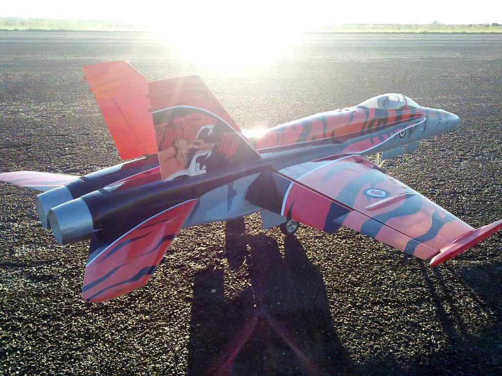

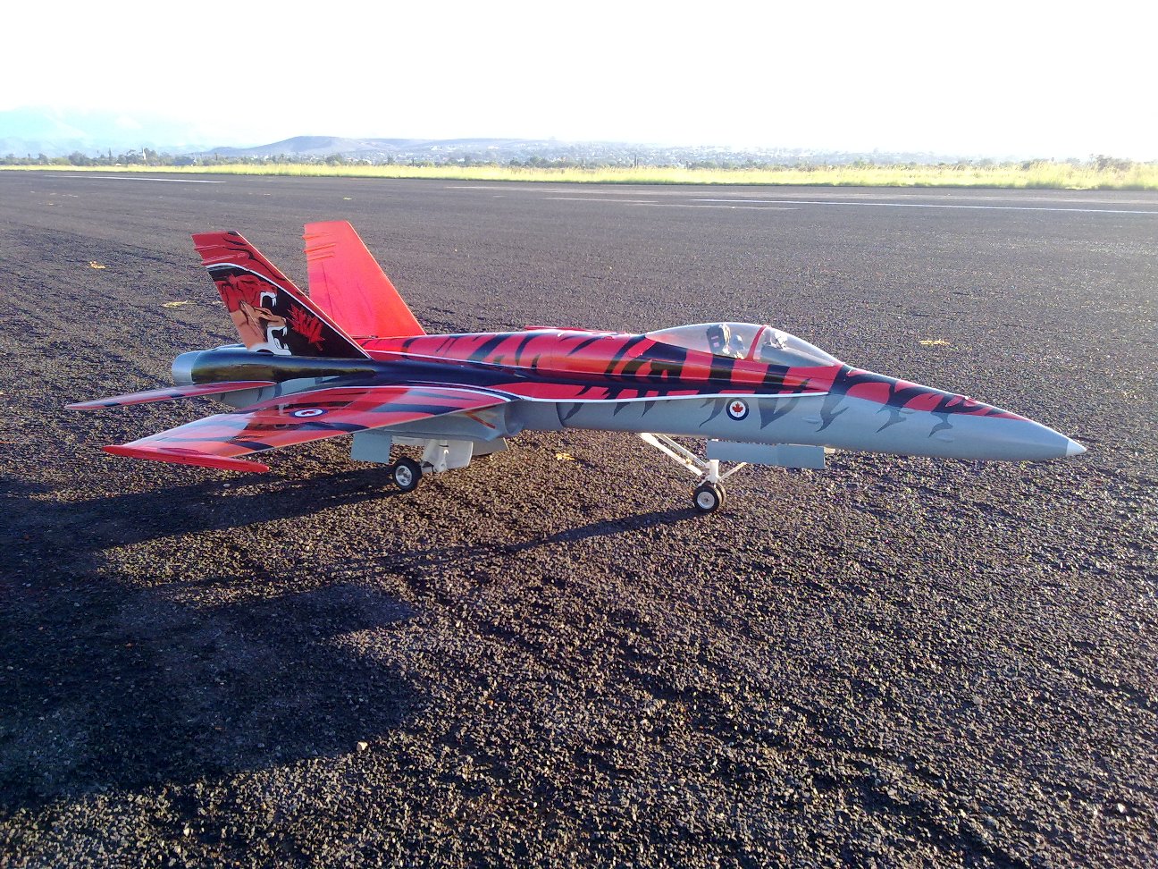

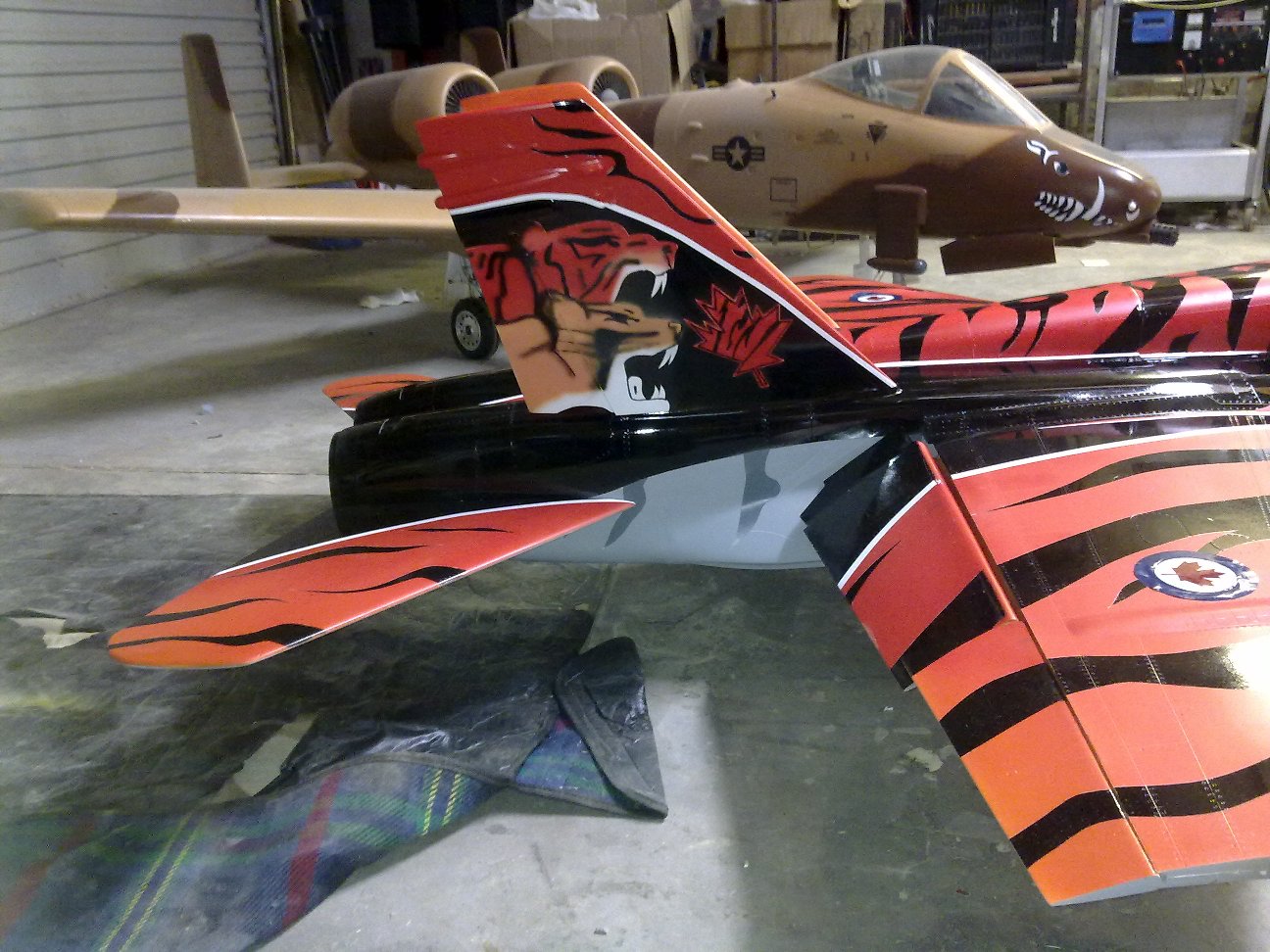

Hi,
I know what you mean. I still regret selling my SM BA F18C. Pianted in the mould with simple setup can fly all day.... So i decided to tackle my all time favourite color F18C. Took the SM kit down from the rafters and did a build and paint in 7 days. Just maiden it today. Man what a nice jet. My 1st go at airbrushing a tiger. OK for me, but the experts might not like it... Now to do this same color on my YA F18 twin...
