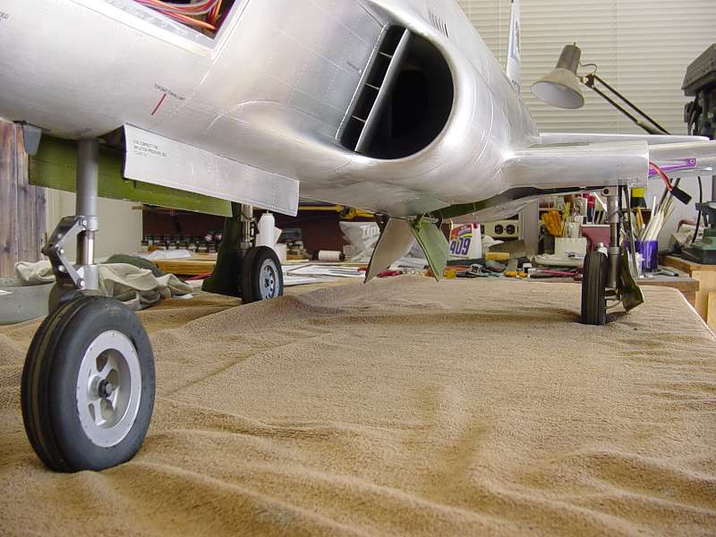

If the gear all travel in the proper commanded direction, you do have the jet plumbed correctly. It is better to use the BVM high-flow valve with approx. 100 lbs. pressure. The new main gear are very robust and require more volume to retract them in a timely fashion.
I have built 2 of the new AFS T-33 kits this year and have found the gear to operate flawlessly once rigged.
If you are still in need of the air-install diagram, it may be possible to get it e-mailed from the factory.

I was not going as high as 100lb psi and also did not use the HiFlo. Two facts to play with later, I also only connected one tank in, as it was a test.
I am impressed with the mechanics though, very well engineered and solid, no play in the system at all.
Daft question, presumably you use the servo slow function to make the raising and lowering at a scale speed, else they would just bang up and down (yuck!)??
As you've built 2 AFS, I would love to hear any comments you have, and also have you any pictures?

The servo slow function on the gear serves to make sure the wheels are up and locked before the doors are signaled to close. On extension, the doors open immediately, followed shortly there-after by the gear.

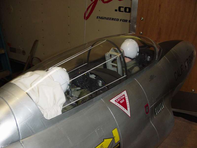

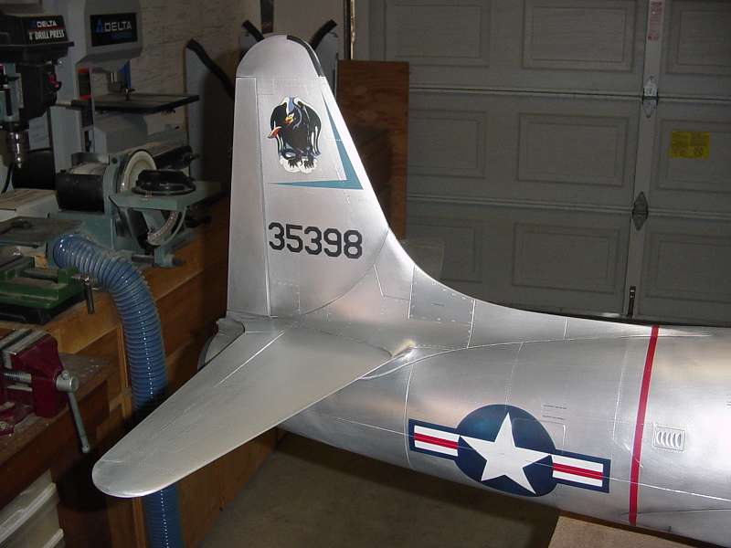

There are several pictures of the first T-33 I built on the website, done in flite-metal. I have several more I can e-mail you if you would like. I also have quite a large collection of standard photos taken over the years when I used to fly the full scale version as a young Lt. in the ANG. If you are interested, let me know. As far as the lights go, the tip tanks had nav lights just about centered on the outside.

Thanks for the pictures, it is a beautiful example, and has given me some motivation. Your right that you get a tool list at the front of the hefty manual, but I could not see what tap and die sizes were needed. I think getting US sizes over here is a bit of an issue, obviously if in the USA, could nip down the moel shop and purchase, but would prefer to get it right before getting my friend to send stuff on!

I do not know of any operational canopy out there. As the engine bay hatch serves to hold the canopy in place while in flight, I think it would require some engineering to make it work. It would be very cool!!!!!(but maybe better left to another project)
