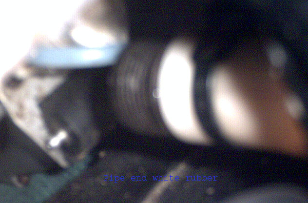

I just started workin on this model and i need help keeping the pipe on. Im not sure how this pipe is held onto the header. It doesnt look like thiers a place for a coupler to mount to on the pipe. Also i need info on what to get for the rubber insulator, it looks like a flat band the header has a flat surface that band slips onto not a round oring style. Maybe this looks familier with you ol school DF guys. Sorry for the low quality pics but they may help[].

Normally, there is a small ring which slides over the pipe end that couples to the engine. The ring will have a spring or wire with tie screws that goes around the engine cylinder. As for coupling the two pipe pieces together, I always used a silicone coupler made by Pranther. Normally used for boats, etc.

Looks like an O.S. coupler. The red ring is O.S. p/n 27126258. JR is right about the springs. If you have the right pipe, you don't need an outside coupler. I do run an extra o-ring at the base to cushion the pipe flange and help with sealing.

I think you are missing a piece in there. The header shown needs to have either a pipe with a flange built in to mate with it like here
http://www.rcuniverse.com/market/item.cfm?itemId=54757
notice how the pipe has a flange where it mates directly onto the header.
If your pipe does not have this flange already, and it appears that way, then you need a pipe adaptor, these were common in the byron setup. Basically it is the first section of the pipe in the link above, only about three inches long. then you would connect to the other portion of pipe with the silicon connector.
you cannot connect this type of pipe to the header shown with directly with the silicone connecter.

Hey Pat, it apears the pipe i have is a two piece. The black grooved part in front of the white sylicone does slide over the o-ring. Would it be ok to use a good guage of copper wire twisted around the adapter base and sling it around the cylinder?

PM me your address. I have some snap rings and springs you can use.

does your couple look like this one on terry's?

On my Weston pipe, I drilled an extra set of holes next to the holes for the springs. I used 2 springs and a piece of safety tie wire around the cylinder head. That way, if the springs broke, the tie wire would hold it. Mine was installed in a Byron powered airframe and I was worried about the pipe going through the fan.

the westons are known for fatigue cracking around where they meet the header, i would follow Gary's lead on two sets of spring with two holes.
I do like terry's solution of using fuel tubing around the springs to not marr up your cylinder. (see pic in post above)
i find myself partial to BVM's music wire solution.

Hey Pat! Thanks for the perfect illistration, where can i get that spring and ring? i have to slide the header out of the rubber coupler to put the ring on right? Can i put another oring in that groove behind the main oring for more seal? -dann

pat! I got your package, thank you greatly the snap rings are perfect idea. I put two sets of springs with two washers. Great to have people like you to help us out! Thanks all -dann
