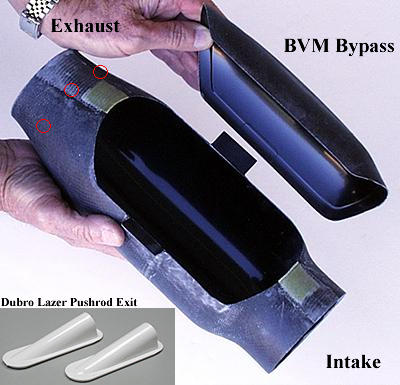

Here is what I did, simple yet very efective. I took 6 of the dubro Pushrod Exits and placed them equal distance apart from each other and right at the portion of the bypass where it starts to turn up towards the pipe. I placed them facing the rear intake. This way it is picking up the left over air so to speak that spills over from the intake inside the bypass and routes it towards the outer portion of the duall wall pipe.
I wish my camera was working I would take a picture for you. My crude graphic here hopefully will explain it a little better. The red circles is where I placed the Exits. Hope this helps.

Avonds cut 1 NACA shaped openings (as they are not true NACA ducts) on each side of the intake ducting to let air spill into the fuse for pipe cooling. The single wall pipe is short of the tail cone by about 1/2" to create the venturi effect that Matt was talking about. Using a single wall pipe, heat proofing using BVM heat shield or ceramic blanket is a must for ground ops as air is not flowing well through the fuse on the ground.
