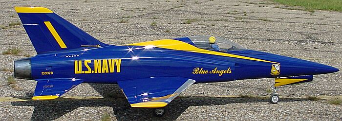

A CAI Raptor ,on its first flight, fluttered and crashed this weekend. This plane was one of the best looking Raptors I
had ever seen. It was a single seat, painted like a Blue Angle.
NICE
Here is what happend. The whole wing fluttered, on both sides.
It happened at ~180, the plane slowed down
when the flutter started, nothing left the plane but
it was uncontrollable and nosed down and hit the
ground at about ~100. It did not roll much and the outer
wing sections, past the gear were making a very loud flutter sound and you could easily see the wings were a blur.
The first reaction was the aileron, linkage broke,
ect, but I saw the linkage, and I know the guy who built
it. All the equipment was top notch. Next to no slop ect..
This should not have happened. I am confident it was not the
builders fault.
This is not the first time this has happened to Raptors
and I want to know WHY. I design a lot of planes and
I would not want this to happened to me. Since CAI
is no longer selling planes, there should be no harm in
trying to figure out want went wrong.
The (rumor) is 3 of 4 CAI F-100 did the same thing. WHY ?
I have a theory.
Think about this. Your in a 747 sitting even with the wing.
You can see the wing moving up and down, and twisting.
If the 747 were to pull 2g's, the wing would bend up
and also twist some to give it washout.
What would happened if instead of washout as with wing
bent up, the wing would twist and produce wash in ?
I think the wing would start to flutter or just break off.
So... I clear you must build a wing where as you load it,
and it is bent it up, it twists in a manner to decrease
the AOA near the wing tip.
All CAI wings were molded top and bottom with glass and
balsa witch made a very nice, stiff, strong wing. This made
a hollow wing witch used a laminar flow airfoil where
the thickest point was farther back than most model planes.
All wings will twist, loaded with G forces they twist around
the axis of rotation for that wing. Its just a line that
the wing will twist or rotate around. Remember, at 200mph
it only takes ~0.2 deg AOA to fly.
I think the axis of rotation, was behind the center of lift....
Was this a problem in the past with full-size aircraft.. ?
Does anyone hear of this problem before.. ?
Eddie Weeks

Lack of torsional stiffness is the usual culprit when a wing flutters. I should know since I've lost 2 molded aircraft due to wing flutter. In the post crash invesigation I saw that there were no layups on a bias . I couldn't believe it !!! Check the Raptor remains and look at the layup. You might be surprised !
I believe that Eddie is correct about "I think the axis of rotation, was behind the center of lift", but I think there may be more to it. If it was only that, a divergent situation, the wing should just break off. There is a more complex dynamic element here, most likely that the aileron gets into a mode that causes the wing/aileron system to tune up at a certain speed and all hell breaks loose in the form of drastic, full side of a wing flutter. Very bad news. What does everyone think?

I think Mark is correct. What Eddie describes is similar to the X-29, forward swept wing. The wing would just rip off, not flutter.
I seemed to remember hearing that the thickness of the ailerons on CAI stuff did not match the TE of the wing. If the control surface is thinner then the wing, doesn't this excite flutter? Probably one side started to flutter first, and the vibrations kicked the other one into flutter.

From what I remember (may be wrong) the plane was
perfect. The thickness of the wing match the aileron
and the builder molded his own pockets for the aileron.
Another note: The raptor wing is a very heavy wing
weighing in at around 10lbs...
Isobar wings are far lighter and not near as strong.
I agree with Rocketman about its likely for more complex
than what I discribed.
All other planes have ailerons with the same linkage
and there not fluttering. That is why I think its the wing.

A very heavy wing probably means very heavy control surfaces. If the wing is low on torsional strength, that's a perfect set-up for flutter.
It amazes me that we get away with as much as we do considering we have unbalanced control surfaces and somewhat flexible actuators.

I was there this weekend with Eddie and saw the plane before, during, and unfortunately after this incident. The plane was very well built. The owner is an excellent modeler and had gone to extra effort to make sure the linkages etc... were done correctly. The ailerons were hinged using scale hinging, similar to the way BVM does the Phantom, and F-100 hinging. I did not grab the control surface but it appeared to be built right. I can not speak for the torsional rigidity of this wing but I did have a Razor in my shop for a short period of time and I thought it had a very stiff, and heavy wing. It is a shame the airplane looked really nice.

First of all not all Raptors have this problem, this one Gorgeous Raptor was being flown for the first time with a wing that that was never sold to anyone, this was the first time it actually flew as some beefing was done to this one particular wing by the manufacturer.

Not that it matters, but here is the plane.
Note how well the aileron fits the wing.
There is a big problem with my theory of the
crash.... There are quite a few Raptors flying
with no problems. If it was design problem,
all of them would flutter assuming all the wings
were built the same way.

Your description is that of a wing that flexed under flight loads, and due to continuos oscillation and MAY BE lack of glue in the spar area, it prevented the wing from stopping to flutter. Since there is no damping at this point, the wing will continue to oscillate to failure. Aileron flutter seems not to be the cause from your observations. There was some talk ( as above ) of some wings that escaped proper gluing processes.
I have a Razor composite kit and one day I may finish it or sell it, but overall I am not happy with this product's quality and this does not make me feel any better

So sorry to see such a beautiful model go down.
Regards,
cactusflyer
The point is, looking good on the outside sometimes has nothing to do with what's gonna happen at "cruise" speed..the devil is in the details of the kit production and quality control.So sorry to see such a beautiful model go down.
Regards,
cactusflyer

Are those composite wing structures hollow with the spars internal?
It seems if this is the case the glue joint at the spar becomes so much more important! With a balsa or foam structure wing, there are many more areas loads can be dispersed.(entire surface area of the foam or across ribs/spars
Mike
Mike
