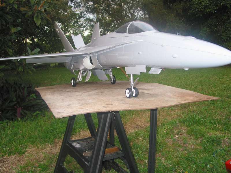

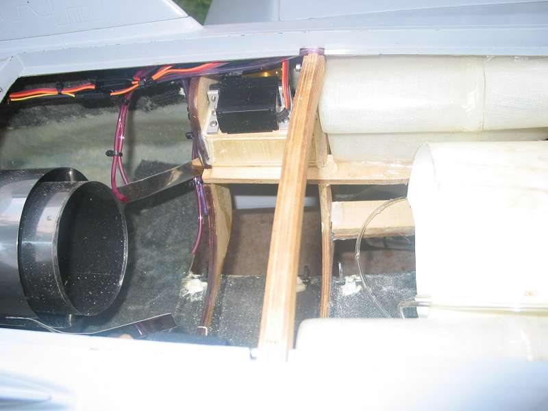

Old 11-22-2004 | 06:15 PM
Posts: 2,580
From: Mia, FL
Default RE: SKYMASTER F-18 HELP NEEDED
I also install the FLAP SERVO inside. I had to do some adjustment to prevent the servo from binding. Is there anybody using this setup??

Old 11-22-2004 | 08:40 PM
My Feedback: (27)
Joined: Dec 2002
Posts: 1,175
From: Jasper, GA
I actually had mine installed inside and fine tuned, but there was way too much slop in the control throw. I ended up using Barry's measures and all worked out well. The only thing I would suggest is to reinforce the spar to wing skin joints with aeropoxy once the hole is cut and I might lay some carbon fiber cloth down next time to strengthen the wing skin where the servo attaches.
