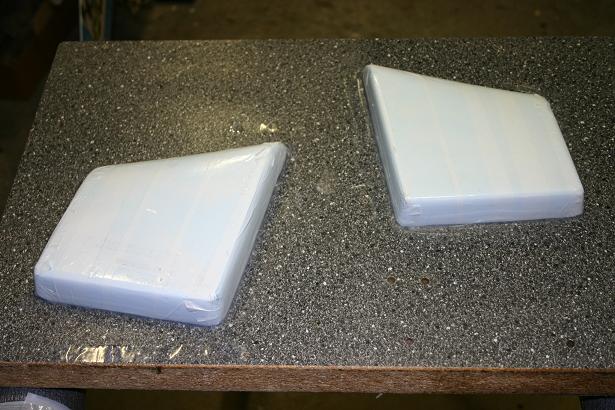

Hi guys!
For those of you, who have a bit of blue foam, some fiberglass and resin and an old DuBro tank-fitting: Just make your own fuel-cells. In my opinion, the Mecca-tanks are to expensive for the quality they have. I decided to mold my own tanks over two foam-halves, just covered with tape.
The duBro-fitting is held by a very short aluminium-tube (from one of the crashed jets?), which is glued into the tank just before assambling. The fill-fitting is a 4mm brass-tube glued to the lowest part of the tank. It took me three nights lazy work. I think 2hour to cut, sand and prepare the molds, and 1 hour glassing for each tank. Another hour for the final work, like cutting the edges, glueing together, setting up, etc. That makes 5 hours at all. Compared to the time we spend to build our jets a very short period. Have look at the pics:
David

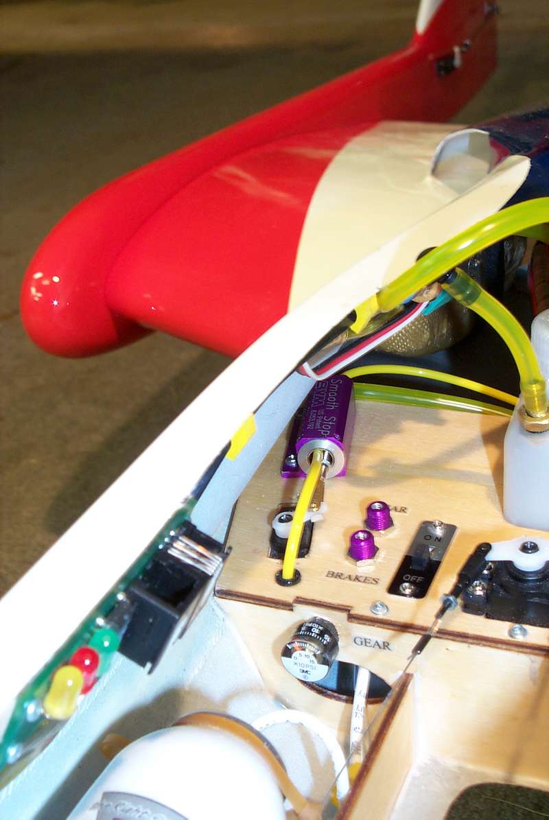

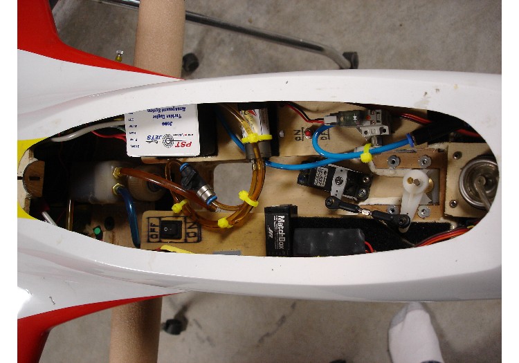

HI guys!
Here a few pictures of my actual installation. It is not 100% finished, a few cable-ties, a few different things, but it should be o.K. for the maiden. I don't use a switch for the battery, just a hi-power-connector.
The fill-lines for air and kero are stowed in a glass-tube at the left side. After filling just push the back and they will stowe in the rear fuselage....
The Gas-filler-line is hiden on the right side. I don't use a gas-container with the small engines, as a few of them need a lot of gas (my dad's PSt J-600 needs heaps of gas!!! One start of the PST needs the same amount of gas as three or four starts on my P-120).
I have just the turbine-battery and a small air-canister for the nose-gear in the nose, so there is plenty of room left. I hope the C/g turns out right. Maybe I have to reposition the turbine-battery or change it to Lipo.
YOu can'T see the speed-brake servo. It is just heat-shrunk and glued into place. If something is wrong with the servo: Just cut the heat-shrink, sand it away and glue a new servo.
It came out with 16 lbs weight. I think that is very heavy for such a small plane. It could be much less with use of the right techniques/materials. Or have you seen any carbon-fibre on your Tangos? No sandwich, just the small strip between the fuel-cells... I think it would be possible to save at leasr 2-3 lbs just on the airframe!
