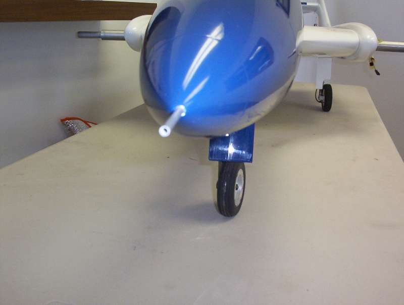

I ordered it on a Monday, had it Thursday. Took all of an hour to install. The system works flawlessly. My KC weighs 30.4 pounds dry(with uat full), power is a P-120. Straight and level with a couple of clicks above half throttle-182 mph. The nice thing was my spotter reading out air speed on downwind, base and final.
Well worth the money in my opinion.

BTW, the interior of you KC looks great.

That's a good question. I have another. Does the unit not have a static port? I can't see how you'd get good speed data without a good reference point.

Yes you assign a channel. It has allot of channels available. The static sensor is inside the case of the recorder. It also records altitude and rate of climb/decent along with allot of other stuff. I use the unit too. Have two of them.

If the static port is inside, how accurate are the readings? The interior of the fuselage tends to be in negative pressure which will make it look like your going faster than you are.
