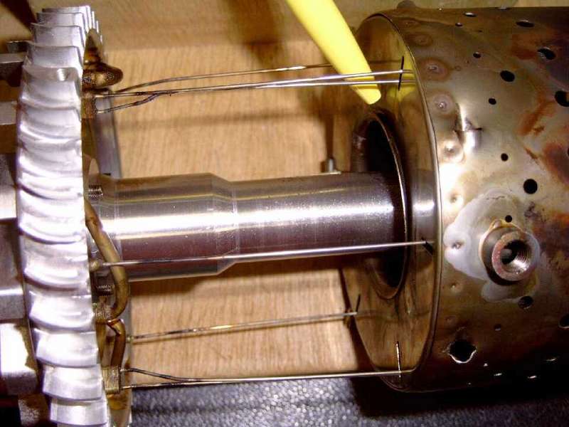

I'm no big fan of the jetcats. The fuel injectors run straight through the combustion chamber, construction methods of the chamber are more or less the russian variant rather than quality workmanship, and worst of all: jetcat ecu really jams into your radio. Crashes due to radio interference are usually linked to jetcat ecus. I've never seen an interference with a projet ecu....and if you excange the two, you will suddenly notice a much longer range on ground tests.
I dont know how it is in the states, but here in germany, jetcat pricing is also pretty high compared to other turbines...
I would go with FrankTurbines, SimJet, RAM, AMT (if you have the $$$) or similar.....generally speaking: if it is supplied with a projet ecu its probably a good reliable unit....

That is an interesting comment about the JetCat ECU. I am considering another turbine for a small jet. I am looking at a Wren44 or a JetCat P60. I would say a majority of the jets in the U.S. are powered by JetCats. What concerns me is the high number of unexplained crashes at U.S. fly-ins. That is why I have had some reservations about going with the JetCat line.
What do you mean by the injectors running straight through the combusion chamber? I have built two Wren MW54's and the injectors go into the vaporizer tubes which are S shaped.
Hal
Hal

As for the design of the combustion chamber and fuel needles, this I guess is a matter of personal preference. I believe that there is much better mixinbg of the fuel with teh design JetCat uses. I knwo Carlos has commented on how even the burn and such is on a JetCat compared to the older Ram line.

Concerning the combustion chamber fuel injection: it does preheat the fuel a lot better, however over time these injectors had a habbit of burning up.

Gazzer, i love the wren stuff too. Have a homebuilt MW54 running in my Sabre...sweet little machine. A few mods to the MK1 design and now the small devil is pushing 6,3 kilos (a tad more than the current MK3 i believe). I also have it running on the so-loved ProJet Eagle ECU.
I was also the one mentioning the russian manufacturing methods......as for JetCat, the chamber vents are more or less bent "by hand" rather than using production rigs....so no 2 vents are going to be equal, reproducability is near zero (thats why many of the bees have to be disassembled and fine-tuned before going into sale). I just don't like the thought of that in a high tech turbine....
(nothing against the russians, they are very able to produce fine products with crude methods, especially in aviation....and quite often have a lot of more innovative approaches. I just don't think that a 50lbs hammer is the right tool to fix every problem
Don't get me wrong, JetCat was leading the jet age a while back, but they have "rested" on that reputation and let many innovative ideas pass by....that, combined with the ECU problems, makes me look away from JetCat.
)Don't get me wrong, JetCat was leading the jet age a while back, but they have "rested" on that reputation and let many innovative ideas pass by....that, combined with the ECU problems, makes me look away from JetCat.
Mini flyer,
you make some fair points, nice to see you have a tuned wren!
High tech and accuracy can however sometimes limit cost effectiveness. If the chamber vents are not that critical, i.e. a high tolerance produces little discernible effects, then introducing a jig and accuracy will only slow down the process of manufacture increasing the costs. Perhaps and I am no expert, this is why it is hand done because it is not that critical.
I guess the only way to find out is to test several engines post manufacture under the same stringent basis, and then to play around with the chamber vents.
50lb hammers do have their place in engineering, but I do agree, subtlety is sometimes a better approach!!!
Gazzer
Gazzer
