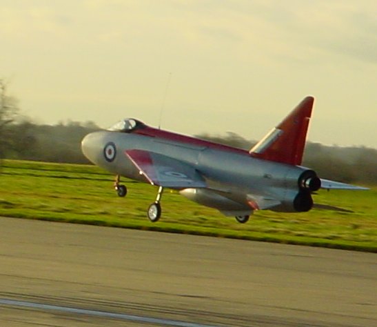

Also Nice attempt to recover w/o LGs, was it on full flaps?
Best Regards
Albert
AsiaScale RC

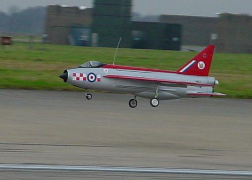

Old 01-07-2005 | 05:11 AM
  #27
nmacwarbirds's Avatar
Joined: Dec 2004
Posts: 1,569
Received 17 Likes on 15 Posts
From: Coltishall, UNITED KINGDOM
Default RE: Lightning first flight video
Dear Albert
Yes the flaps were fully down.
There was a leak in one of the retract leg cylinders
which is now fixed. We have changed tactics for the landing.
Full flap is deployed downwind, then the model is turned into wind and flown
back down the runway. When the model is relatively close to me at about 20mtrs
in height, so then I can judge the speed more accurately then the gear is lowered.
That seems to have done the trick.
Second and third flight video will be posted soon.
Regards Phil G.

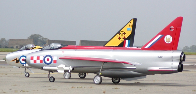

Old 01-07-2005 | 04:53 PM
  #28
Joined: Mar 2003
Posts: 4,575
From: New York, NY
Hi all !
Here is the link to the 2nd flight video [8D] : http://menez.thomas.free.fr/lightning2ndflight.wmv
Thx for sharing Phil.

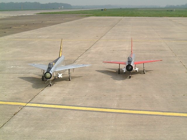

Old 01-13-2005 | 04:59 PM
  #32
Joined: Dec 2004
Posts: 1,569
Dear All
Here are the main protagonist's, behind the Lightning project.
Left to right.
Myself (Phil Goff), Pilot/Builder Mark Dyball, Radio and Jet Installation, Clive Goff, Builder/Owner.
Regards.

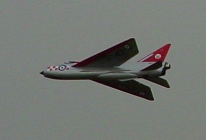

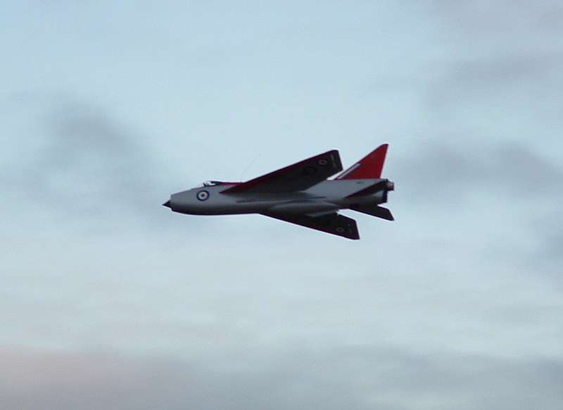

Old 01-16-2005 | 02:17 PM
  #33
Joined: Dec 2004
Posts: 1,569
Dear All
The LIghtning has been out again today.
Complete with chequer board and firebird decals.
Here are some pics.
Regards Phil G.
