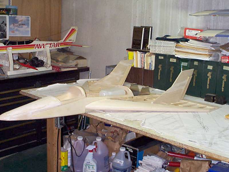

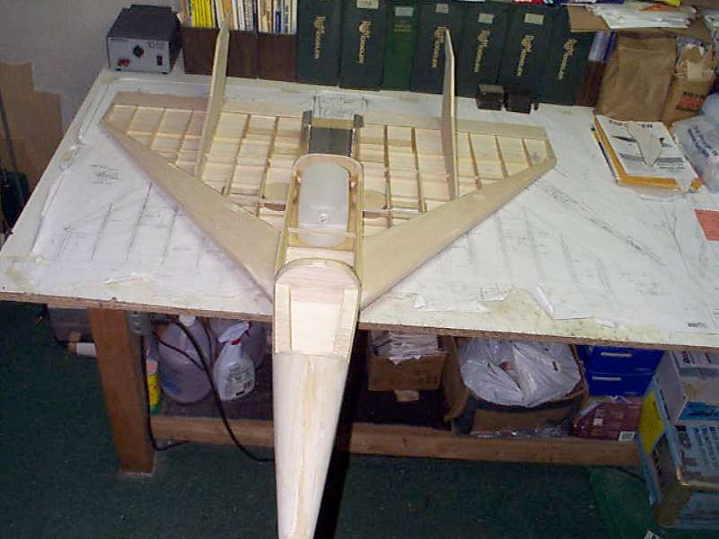

Due to popular request (Bob) I'm posting a couple pictures of my winter project. I needed to find a home for my recently acquired Ram 500. After looking into some of the various kits available I decided to build another Enforcer. My Byroblaster Enforcer is a blast to fly, and with close to 100 flights now I'm very comfortable with it's flight characteristics. So this seemed like a good choice for my first turbine. Also I just happened to have a spare kit sitting in the basement.
I'm almost done framing it up and expect to have it ready to fly in the spring. It will have many of the same mods I made to my DF version. The most noticeable differences are the wider fuse, to accommodate a 50 oz. Dubro tank on the CG and the aluminum motor mount. The wing will be fully sheeted once everything is in place. A removable cover will go over the rear fuse for easy access to all of the equipment.

OK so I twisted Joe's arm a little....
First twist was to get Joe to buy a turbine since he has been wearing a RAM hat and T-shirt for some time now.
Second was to get a turbine an airframe to reside in.

The turbo will have spring air retracts, 3/16" wire struts and BVM wheels/brakes. I was planning on kicking the rudders out board as a speed brake. I'm now realizing that will tie up too many channels and mixes on my 8103. Seems like a good excuse to upgrade to a 9303. Any opinion as to which would be more effective: outboard rudders or speed brake on the bottom?

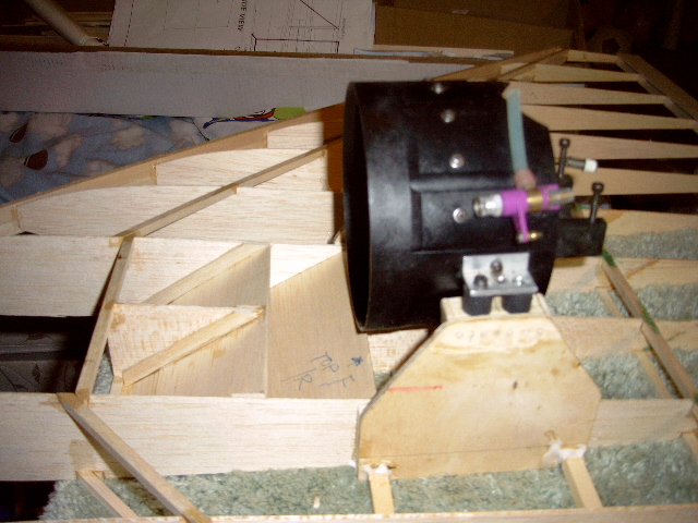

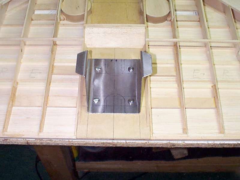

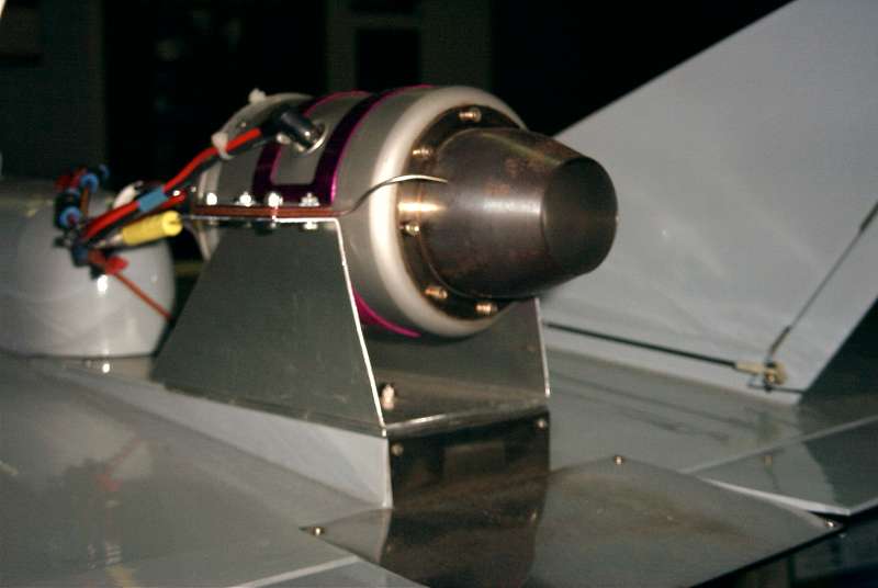

Very nice Joe. Can you post a closed up picture of the engine mount from above?
Thanks.

Bob/Chris,
OK, you convinced me. I'll put a speed brake on the bottom. It would have been easier if I made provisions for one earlier. I'll figure something out.
Exactly where are yours located on the Rookie and Top Cat? I'm thinking that it belongs 1-2 inches in front of the CG.
Anyone have a recommendation?
Joe

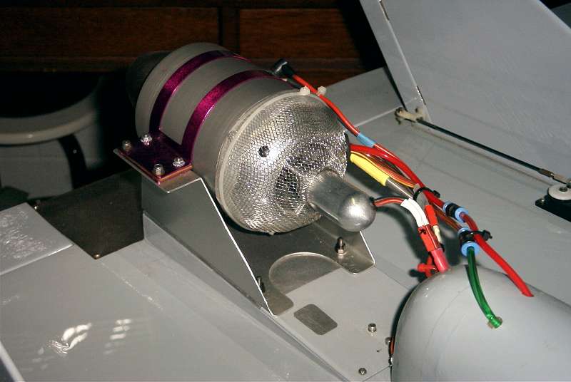

Cars,
Here's a couple of shots of my engine mount. It looks a lot like Larry's because I got the idea from him. Mine is made out of .064 aluminum. Thinner guage would work, but that is what I was able to find. I'll probably put a few holes in it to lighten it, but I'll wait to see how the finished plane balances out.

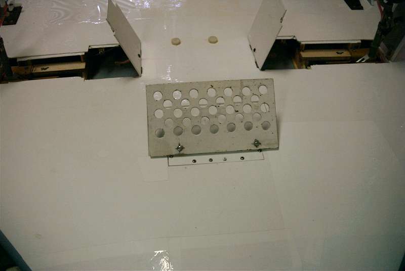

Here's my speed brake layout. It works well and it pitches the nose up a bit when deployed. The well area also gives you access to things such as the brake valve and fuel tank. The well cover just pops in and out for service.
Larry

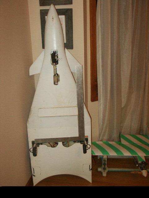

JOE
THE SPEED BRAKE on my ROO bigger than plans 2.75" x 11.75"
LE location is about 10.5" ahead of CG (CG is about the LE of Robart retracts)
(yes gear are offset since mounts were glued in wrong: one off by 10mm )
actuation by JR DS-8411 servo
Bob

Thank you Joe, you know I end up with the same engine angle purely by chance and wow!!! it flys perfect no need to change the engine truss angle.

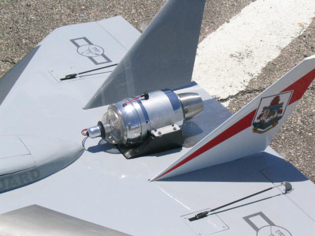

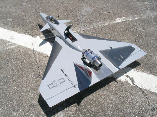

Hi all,
This is a good thread. I built one of these last summer, with a Moores Super 66. It is super fast and stable.
A real blast to fly.

Chet,
Very cool! Is that a modified Enforcer? Kind of looks like a Reaper.
Is that your gas tank on the bottom?
Joe

Hi Joe,
This is a Balsa USA Enforcer Kit. The tank on the bottom was for extra fuel.
I don't use it any more. I modified the kit to use a larger tank inside. This motor needs fuel.
The jet weighs 16lbs, and the motor has 22lbs of thrust. I have Dave Brown Carbon fiber ribbon
on all spars, and trailling edge. She turns very tight!
I got the idea to build this kit from you Joe, as I had seen your ByroBlaster on RCU early last Year.

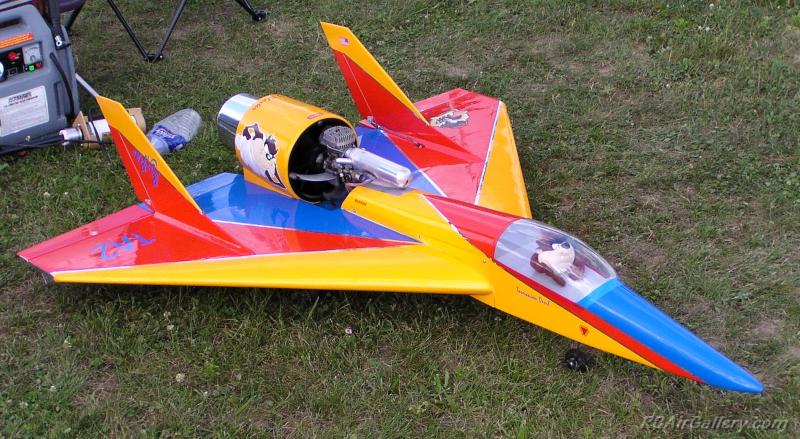

Great looking Enforcer Chet. The Enforcer has got to be the most versatile jet there is. I certainly enjoyed flying mine. It flew first with my Schreckling FD 3/64. Great match except if the grass was too long it would not take off. I then installed a RAM 750 but I had to kill the engine to land it. Too much idle thrust and it would not land. I finally installed a RAM 500. It flew with it till I retired the Enforcer. It weighed 12.5 lbs dry with the RAM 500.

Chet,
You did a great job. I agree with Larry, the Enforcer is a very versatile air frame and seems to be a favorite among kit bashers. It has been quite successful as a pusher prop, ducted fan, and turbine powered plane.
I assume that you fully sheeted the wings. Are they glassed or monokoted?

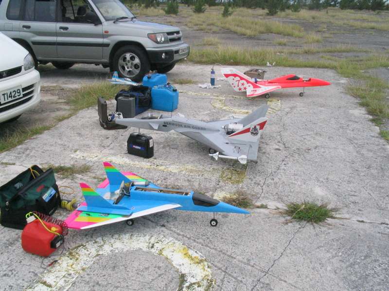

Hey Chet,
Nicely bashed Enforcer! Where, by the way, do you guys fly in Bermuda? Nice old tarmac! Don't suppose you could host some visiting pilots from up north (Wisconsin) could you?
