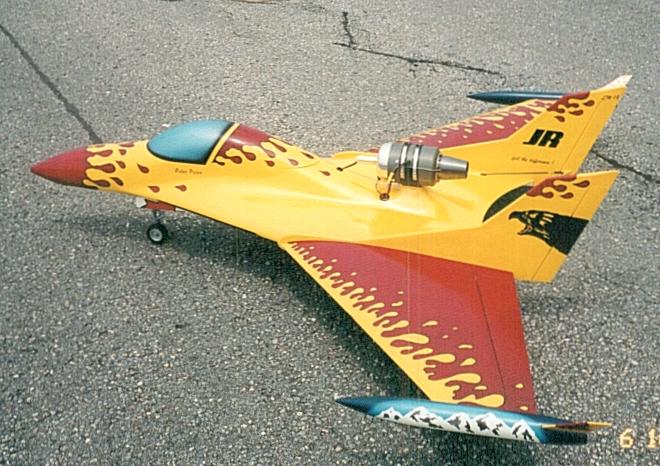

Hi
I'm in the process of designing a sport jet based around the 28 pound thrust turbines. I'm looking for ideas from you to make this a little different from the norm.
Please tell me what would turn you ON?

Are you looking at delta wing or conventional?

I'm open to any possibilities righ now

If you are starting from clean sheet of paper; something as a old pattern flier that I would like to see is longer tail moments and shorter noses. That is why I got the BVM Bobcat XL over the std Bobcat for the longer tail moment.

That has the potential for problems in terms of CG. I never really thought about it until I read Kamp's book, but long tails mean either a long tail pipe, or an engine far behind the CG, and a short nose means more ballast to compensate for the long tail, and/or the engine behind the CG.
Even if you don't mind a long tail pipe and you put the engine on the CG, so its "out of the equation", the ratio of the tail length to nose length has a direct correlation to the weight of the nose vs. the weight of the tail. Since the heavy engine in most prop planes is in the nose, it helps out in the balance department, but it does no good for us. Most of the other equipment in the jet is fairly light (fuel needs to be near the CG and can't be counted as ballast, except for an always-full header or UAT), that means lead in the nose - and the farther forward you carry it, the less you have to carry...

Bob your points are well taken, but long noses are yaw distablizing. If we just stretched the tail moments a bit; not much and shortend the nose moments a bit I think we could have better flying planes. I have 20 years plus designing prop planes some of which have been flown at the TOC by Steve Stricker, but no designs that I have done myself for a turbine plane. I did just today recieve a copy of Kerry Sterner's Facet 2300 serial number 1 on the plans. It has just what I was asking for; a slightly longer Tail moment compared to the nose moment. I will pick uop a copy of Kamps book to take into the points you have pointed out. Thanks for the information.
