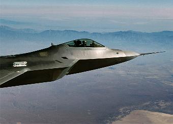

Hello all,
I'm doing an F-22 in two tone silver/grey. I'm looking for techniques to get a soft line without excessive overspray. I normaly use a touchup gun then go back over the edges with an airbrush using the lighter base color to shapen them up. With the metalics I'm using it's not possible beause it leaves a shiny halo around the edge. Any ideas?

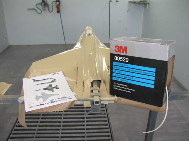

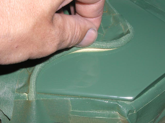

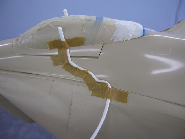

use softtape by 3M. it is available in diameter of 6 mm (1/4 inch), 13 mm (1/2 inch) and 19 mm (3/4 inch). 13 and 19 mm are self adhesiv!
look here, it is German but the pictures are speaking......
http://www.rc-network.de/cgi-bin/bei...;f=51;t=000004
or here:
http://www.rc-network.de/magazin/art...2-0003-00.html

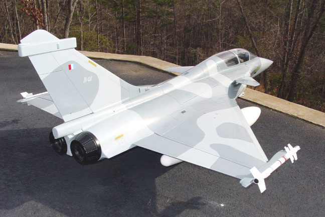

This stuff is also known as Door Apature Mask Tape and can be bought at automotive paint supply stores. I used it on this Rafale and it works well. You can control the crispness/fuzziness of the lines somewhat by how heavy you apply the paint along the masked seams.

Actually, the full scale Rafale (photo below) has pretty crisp lines and least when viewed in a comparable scale/perspective. Nevertheless, I would probably go a little lighter next time spraying near the foam tape.
Let's see a picture of yours to see if it "looks right".

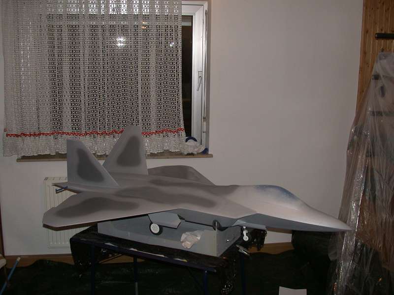

production F-22 have a silver sheen to them. Knowing your background you can guess at its properties. I ended up mixing about five parts silver to one part grey to get close. Inside it looks flat dark grey. In the sun it looks much lighter and shines a bit. This is going to be fun to see in cloudy weather. Using this much metalic prevents me from airbrushing around the radius with out leaving a silver halo. Here are a few shots of the work in progress.
