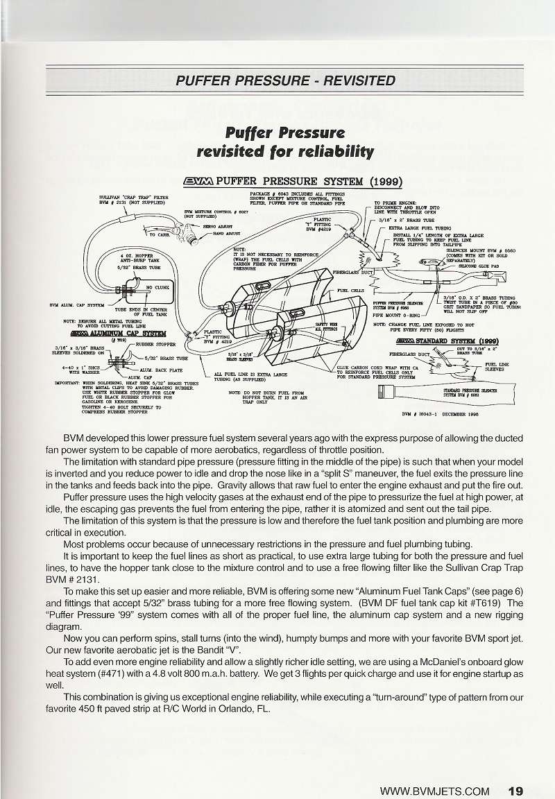

Hey guys,
A quick question. If I'm running split main tanks, in parallel, on my Eurosport, do I need to run them into a third header tank before they go into the UAT, or can I run them straight into the UAT right from the "T" in the supply line? Is this third tank necessary as a bubble trap, or is the UAT sufficient for that purpose with split mains?
Thanks!
Bob

[quote]ORIGINAL: rhklenke
Hey guys,
Thanks!
Will this help ? And since you are running a turbine -just forget about the tuned pipe......
