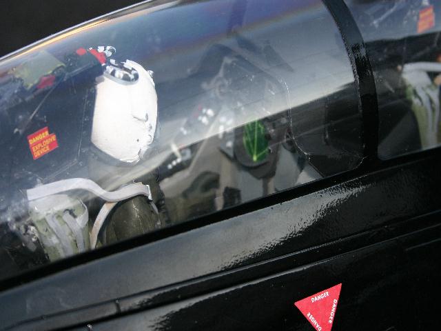

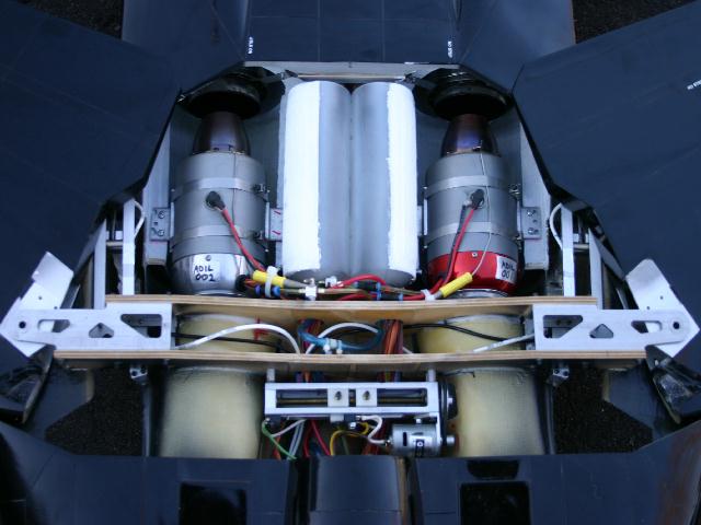

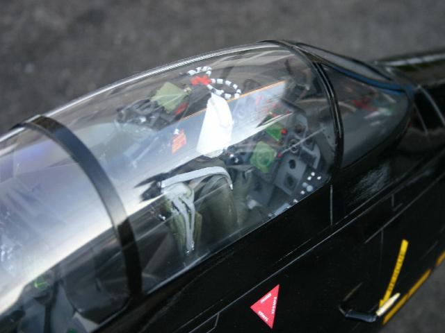

Hi Guys,
Thanks for all the replies. I think, I'm going to try the Kokam 2000 packs as I have a couple. I will probably remove them to charge as it will be no problem - I made a hatch where the batteries are. I pretty much sacrificed the scale details for ease of servicing and use on this project. Below are some pictures of the hatch and the cockpit. The plane balances slightly nose heavy which I believe will be taken care of now. The culprit was the cockpit detail as it come out slighly heavier than thought. BTW, not a ounce of dead weight on this plane which I'm proud of as well
Regards,
Adil
