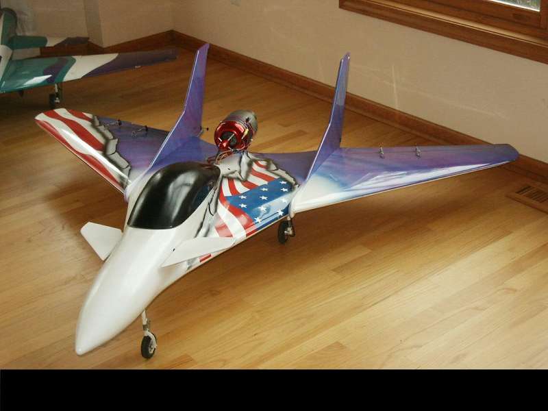

Old 02-28-2005 | 07:12 PM
My Feedback: (17)
Posts: 144
From: commerce, MI
Default RE: Kangaroo Engine Mount Problem
Those canards are cool on your roo, total improvement on how the bird flys, I wish I had the room to do it.
