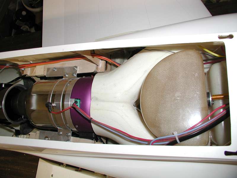

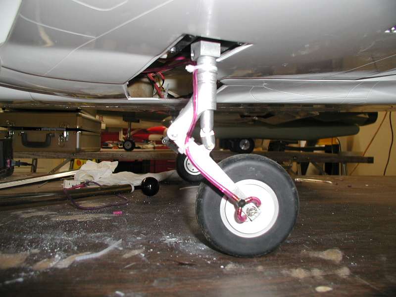

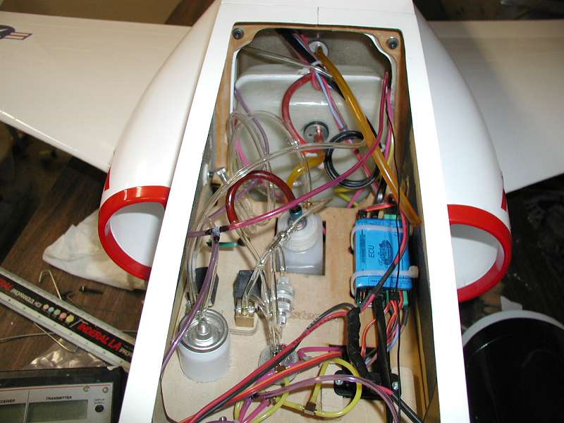

Hi Morne, this may be a duplicate, the first one I sent may not have gone through, here are some pics of the set up.
I did not use flaps on the entire flight.
I did retract the gear.
I did forget to put the rear cover on the speed break.
I placed the ball link on the 2nd hole from the end as not to touch the outer wall of the exhaust pipe. I am using a JR8611, and upon inspection after landing the elevater seems to be rigid and strong??
So take a look at my set up, and tell me if you see anything. Also, the ailerons worked perfact.

Hi Kevin,
Nothing i can see on the photos to suggest such problems! Doug is on the right track and i bet is an incorrect linkage/radio setup. Had a problem like this on my canards of my Gripen.
