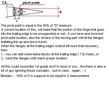

Matt,
You are right about that the Viper rudder has a tight taper.....
In solved that by adding some balsa blocks at the hinges holes location.....I think you called that gusset, right?
I the other Viper thead I posted another draw explaining the same problem.....I still have the idea that some of the guys are not getting the picture [
] Anyway, for all of you.....here I go again [&:]
Thanks for the complements
See you.-

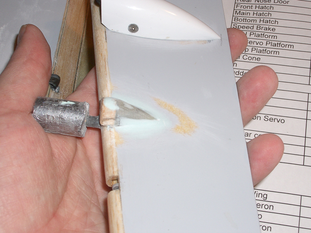

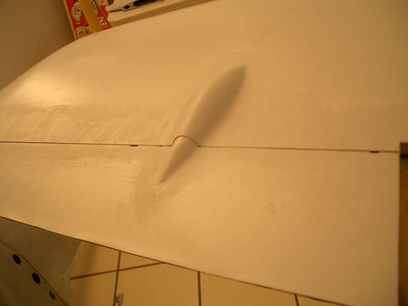

ORIGINAL: mr_matt
I agree, adding vertical gussets would make the exposed part of the hinge even stiffer, you can always improve!!. In my Stingray, I ended up with some pretty healthy fillets so I figured what the heck.
I have attached a couple of pics, see in the second one, I quit trying to make the clearance holes for the hinges on the movable piece, and just made the radius part in sections, so those slots in the elevator will clear the gussets.....Miguel did a great job of explaining the problem in post 58.
I agree with Tom, I would rather just cut this stuff out and do it myself...I spent more time trying to get the hinges to work on the Stinggray rudders, I think it has the same issue as the Viper, the taper was not right ....to me this will be hard to do on any ARF and is a little much to expect at the price, IMHO....you want those killer fits you almost have to do it yourself.
Having said that the only "ARF" I have seen that had predrilled, perfectly fitting hidden hinges is a Tom Cook Firebird, never seen anything close to the prefab and fit/finish on any arf.

#83
So, you guys are suggesting that mass balancing to 100% will move the natrual flutter freq higher which is a good thing. I'll try it as I have never done so in the past.
The VPII has servo helpers forward of C/G line on tail surfaces so it is very easy to drill a hole and insert some heli blade style round lead (YIKES, a four letter word).
Thanx for your input.........

#84
Certainly the stiffer the system, the better off you are and the higher the speed at which things will go a flutterin'. But I am not so sure that it can be obvious with a twist of the hand that the system is too stiff to get into a torsional flutter mode. Obviously the more torsionally stiff the surface is, the higher the flutter speed and therefore the better off you are, but its still out there somewhere. If you are gonna put weights out in the tip, I'd be real certain to put lots of carbon fiber oriented at 45 degrees in the skin.
Matt, that counterweight is TOO COOL. Was that on the Bandit's (or Stingray???) elevators or ailerons?
