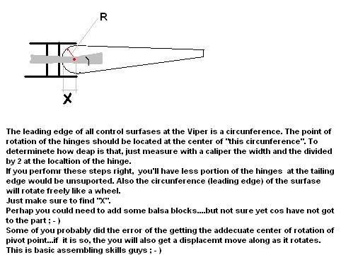

I've not seen the hinges on the Viper, but from what you are describing, it sounds as if the hinge protrusions you mention are done kinda like Matt showed us in http://www.rcuniverse.com/forum/fb.asp?m=762242 - is that correct ? Note the pics in posts 23, 24, 27, 28.

Just aquick question here about the hinging on all the viperjet surfaces. I saw a kit recently and can agree that you will leave some portion of the hinge unsupported. I can honestly tell you that in my eurosport the rudder was the same way. It had an arm failure and fluttered like there was no tommorrow. The rudder never even came loose. Not to say that that is right that part of the hinge goes unsupported, but I built up the unsupported hinge with a little hysol before i attached the rudder, maybe that was what held it, I dont know. But my proposal is, and Im thinking about the hinge line on the viperjet, why not place a 1/8 or 1/4 piece of ply on top of all the holes that exist in the viperjet hinge line, and drill the holes again. Now you have built the hinge line out to the unsupported portion of the hinge, and now its supported. Can anyone see a potential problem with that? If not that should solve it.

Many moulded kits including Fiber Classics, Airworld and Skymaster that I have built have extended trailing edge surfaces on wings, tail plane and rudder its simply a matter of trimming a couple of millimeters from T.E. overhang to allow control surfaces to butt up against rear edge of wing etc. Its normal and common place and is part of building many composite kits now days.... Even on some older kits going back to Byron days this was the case ie Byron Mig 15

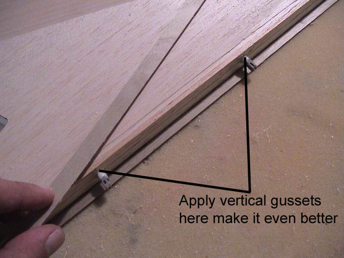

Gordon:
That is what we tried to do.....the only problem we encountered was no being able to properly shape the leading edge of the moveable surface as Matt did....we did not want to grind or sand into the fiberglass, not knowing for sure what was underneath......as it comes, with the very firm overhanging leading edge, almost firm like C/F, not the more flexible skin like on the Eurosport or Kingcat, the radius of the leading edges are too fat, and does not allow any travel.....
So we did build up the aft trailing edges with balsa to the proper depth which consumed a fair amout of time to get right and sanded, and holes relocated, since each surface is a little different, and in fact, each of our kits has a little different overhang, leading to a varying depth of the trailing edge......
Tom

What do you do for a hingeline problem in which a ARF kit is supplied with pre hinged componenets, and the trailing edge of the flying surface is too small of an inside diameter to except a too large thickness of the moveable flight surface to allow for any movement even close to stated?
There are many Jet Kits out there that don't do it this way.

Given the above info - for the "unsupported" portion of the hinge to be a "major issue", wouldn't that now suggest that Matt's technique is totally wrong and unsafe, and we should now all have a go at Matt instead of Tam ?
Sorry Matt - I'm not claiming there's anything wrong with your technique - practically everyone knows that you know how to build a model that is absolutely solid - I'm just using this as an example of how the same technique seems to be able to get rave reviews or get crtiicized, depending on whose name is behind it.
Since this seems to be a rather subjective "issue" rather than an objective one, perhaps those who consider the standard hinge method of the Viper to be inadequate could simply add a "cone" of aeropoxy to spread the load and make it even less likely that the hinge would flex at its otherwise unsupported section. If that's the only kind of mod you need to address this particular issue then IMO some of the participants in this thread are blowing things WAY out of proportion to reality. I wish the ARFs that I've put together needed so little rework. Reworking the gearmounts alone, took over 8 hours on the last Roo I did for a friend !
Sounds to me like this whole subject is basically a case of various people making a mountain out of a mole-hill.
I have no doubt at all that Cermark could make further improvements to their Viper ; I have no doubt that such improvements WILL occur in future, just as they have occurred in the past when Tam & others did extensive testing on the original ARF and sent their feedback to Cermark. I also have no doubt that even if & when we get to a Mk 10 version of the aircraft, there will still be some minor issues (putting bug-fixes into software also tends to create some additonal bugs, so why would we expect that hardware would be any different).
Having a certain amount of issues in a kit or an ARF is simply a fact, and one that will not go away. Doesn't matter whose kit or ARF it is, I doubt that it can ever be 100% perfect in construction, and the manual will never answer every single question that can ever come up. Consumers and manufacturers alike need to recognize and understand that ; consumers need to understand that here are good ways to ask for info from manufacturers etc, and there are bad ways ; manufacturers / dealers / distributors need to likewise understand that there are good ways to respond to questions and / or criticism, and there are bad ways.
Now, maybe I'm just creating a mine-field for myself here by trying to find some kind of resolution, but sometimes it seems that that's where I feel most at home

Gordon:
This thread is moving into the blah blah blah blah zone......last post on this one for me.....
Matt did it right on the Stingray.....his hinges are well supported and geometry is perfect......no need to "have a go at Matt".....let him have quiet night with his wife......having Tam cross-threaded is enough....with all the crap on this thread, barely enough Heinekin in his liquor store to keep him from going postal......
As it comes from the factory, you cannot duplicate Matt's technique with ease on the Viper II.....so talking about it is a bit like apples and oranges, except to see what Matt's correct geometry looks like.....
The 3 of us who are building Viper II's have all recognized the problem and have fixed it to our satisfaction.....along with our HD linkage and 9411's I believe we are out of the flutter zone.......

I agree, adding vertical gussets would make the exposed part of the hinge even stiffer, you can always improve!!. In my Stingray, I ended up with some pretty healthy fillets so I figured what the heck.
I have attached a couple of pics, see in the second one, I quit trying to make the clearance holes for the hinges on the movable piece, and just made the radius part in sections, so those slots in the elevator will clear the gussets.....Miguel did a great job of explaining the problem in post 58.
I agree with Tom, I would rather just cut this stuff out and do it myself...I spent more time trying to get the hinges to work on the Stinggray rudders, I think it has the same issue as the Viper, the taper was not right ....to me this will be hard to do on any ARF and is a little much to expect at the price, IMHO....you want those killer fits you almost have to do it yourself.
Having said that the only "ARF" I have seen that had predrilled, perfectly fitting hidden hinges is a Tom Cook Firebird, never seen anything close to the prefab and fit/finish on any arf.
