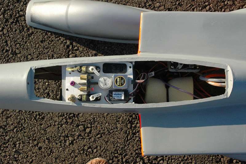

Hi guys,
I have a clippard 3-way, I assume normally closed valve for my Spring Airs. Problem is,when I presurize the air tank, there is an open port that leaks air gradually, and eventually loses all pressure (takes about 2 minutes). The port bleeds air in off and on position, however if I block the port the bleeding will stop, but it won't extend the landing gear.
Has my valve gone bad? Can I use a normal Robart valve and "jumper" the unused port?
David

Do you have the tubing connected to the correct ports? Are the ports labeled?

Well, I assume that the tubing is installed correctly, cause it does retract/extend correctly.
See the picture, it is the one on the left hand side (red button). The air in/out ports are underneath it. The port facing forward of the jet is the one that bleeds off air.

the valve in question is a smav-3 clippard part. david i will pick up a spare for you this week.

fwiw the end opening is the exhaust, and should only let air out when the button is released for a moment.
