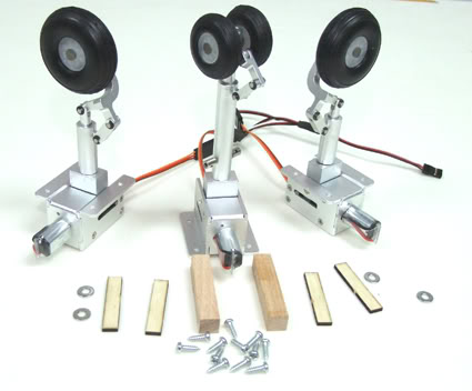

I checked AL's Hobby web site and didn't see this gear package. I'm sure its just been too long. So, do you know of another place to get these gear or oleo's. They look awesome. Thanks in advance for you time.

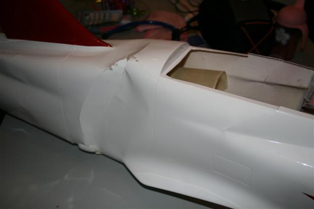

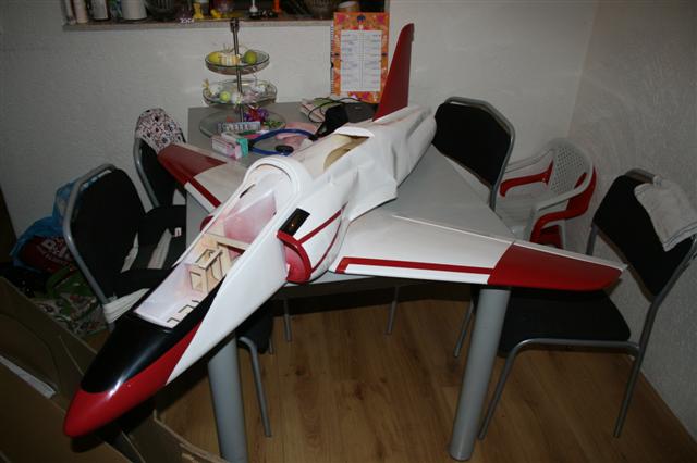

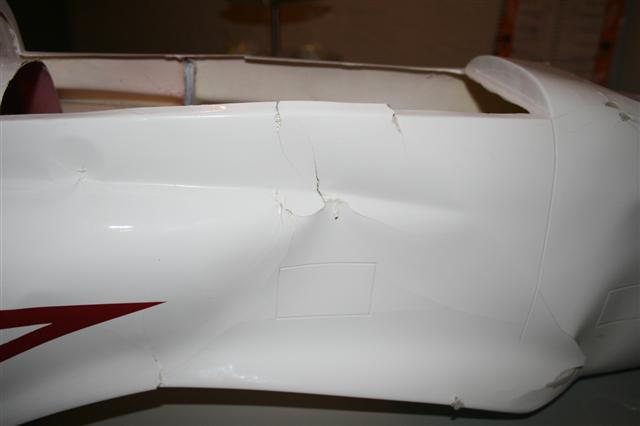

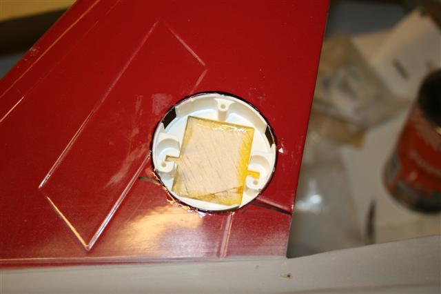

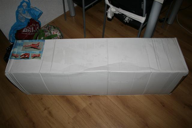

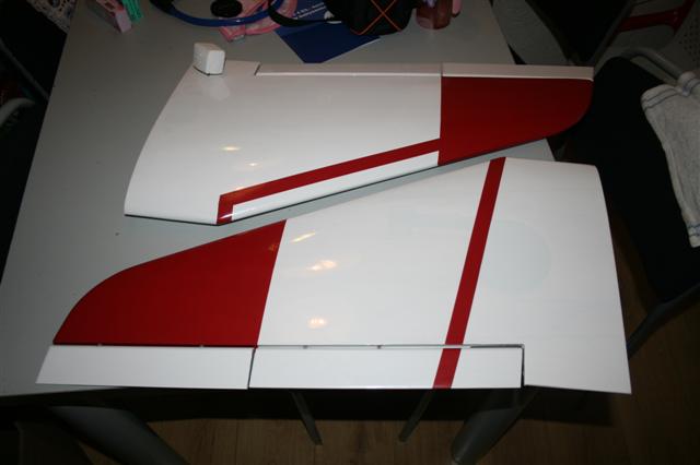

Hye there,
Yesterday I`ve took a Will Hobby Hawk home which was lying in the shop for over 3 years due to transport damage.
I`m planning to repair the fuse and let this bird fly with a turbine.
Can someone in short tell me what modifications I must make to make it turbine safe?
I than can search this thread a little more specific, 27 pages is a lot to read [8D]
Here also some pics of the Hawk.

Old 04-30-2011 | 03:01 AM
  #682
Joined: Jul 2006
Posts: 1,409
From: Norfolk , UNITED KINGDOM
Default RE: AMD Hawk.
To make this model nice to fly it is important to keep it as light as possible. It will fly well on a MW44. It will need a push rod to operate the elevator and we had this sited beside the engine on the side of the fuslage. It needs a nice strong servo 10Kgcm.
http://www.youtube.com/watch?v=40a4c...eature=related
Wire legs may not look so pretty but will save the wing structure with a less than perfect landing.
Dont have too much flap when landing, use crow braking if you can.
It seems all Hawks will drop a wing if flown near the stall point and if it does it close to the ground that may well be the end of the model. If the model is light you will have a more forgiving airframe. We flew with a gyro on ailerons making landings much more stable. We had 3 of them and flew them a lot.
John

Do the mods to the elevator and rudder servo positions you will find the details on this thread or on the RCgroups thread.

Thanxs for the reply`s so far.
I will search for the servo mount modifications.
Will leave the max. flaps as per manual.
Engine? a MW44 will be very nice, as dealer for the Netherlands it also would be good for Wren
We will see, started with the wings for now, fuse will follow soon.
Will also post my buidling here.

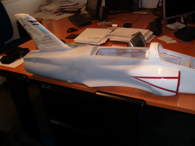

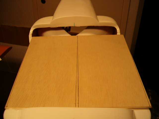

Old 05-30-2011 | 04:34 AM
  #685
Joined: May 2006
Posts: 617
Received 39 Likes on 23 Posts
From: Zeewolde, NETHERLANDS

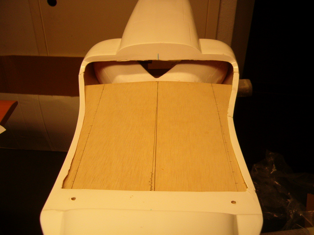

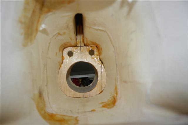

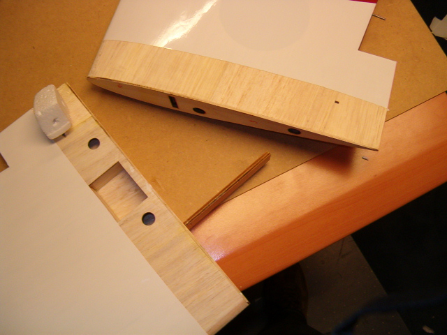

And did some progress [8D]
Made a plate for in the bottom fuselage opening to stiffen and straigthen the fuselage.

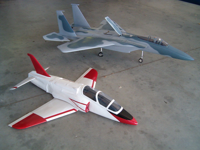

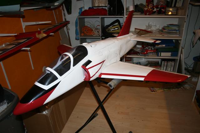

And together with my F15.
They have the same span but the F15 weights 3 times more then the Hawk when it will be finished

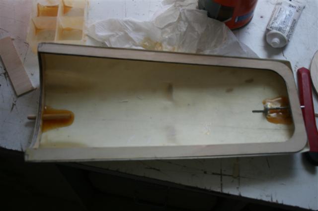

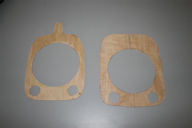

Made some fuselage formers.

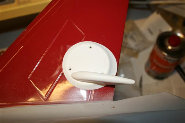

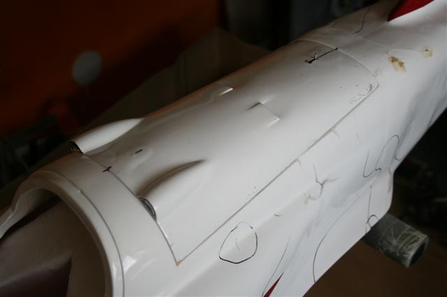

Fixed the top door.

Old 05-30-2011 | 04:42 AM
  #689
Joined: May 2006
Posts: 617

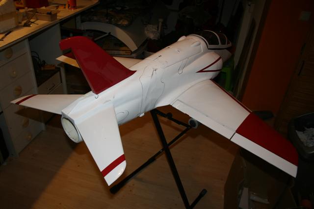

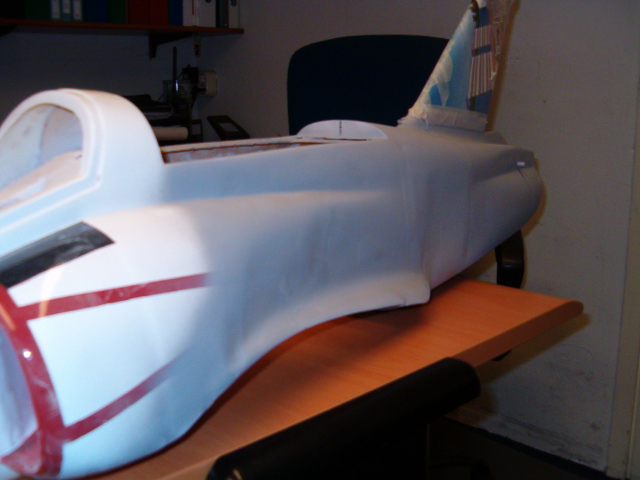

Fuselage almost repaired, the grey paint is filler so I can detect dents, niks and scratches better.
The final fuse will be in a lot better shap but will not be as new.
But what the hack, as it flies I`m happy

About the retracts, which kind of air operated retracts do you guys use and which trailing links will fit this model?

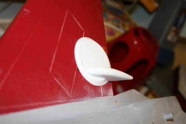

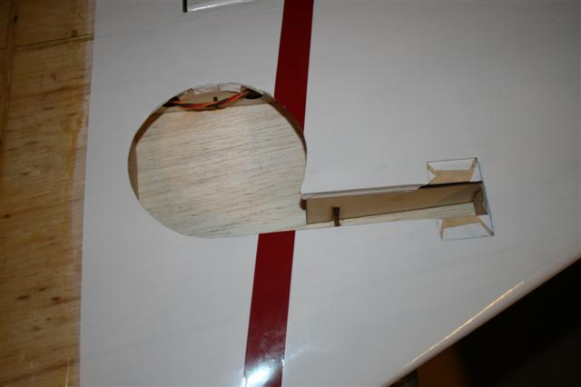

Old 05-30-2011 | 04:45 AM
  #691
Joined: May 2006
Posts: 617
And the modification on the rudder servo position.
If I was building one again I would go for the new electric retracts
I see some are now even advertising a set with legs for the AMD hawk on ebay.
[link=http://cgi.ebay.co.uk/RC-Lander-Full-Metal-Electric-Retract-AMD-Bae-Hawk-/330538463014?pt=Radio_Control_Parts_Accessories&ha sh=item4cf5a0af26]Hawk electric retracts[/link]
[link=http://cgi.ebay.co.uk/ws/eBayISAPI.dll?ViewItem&item=250761695065&ssPageNam e=STRK:MESINDXX:IT]T45 version[/link]

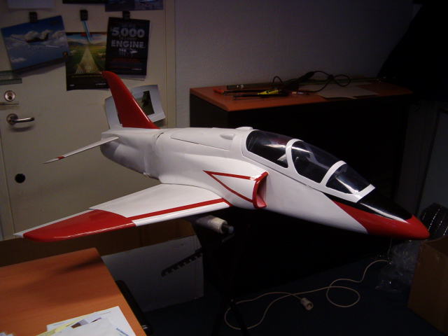

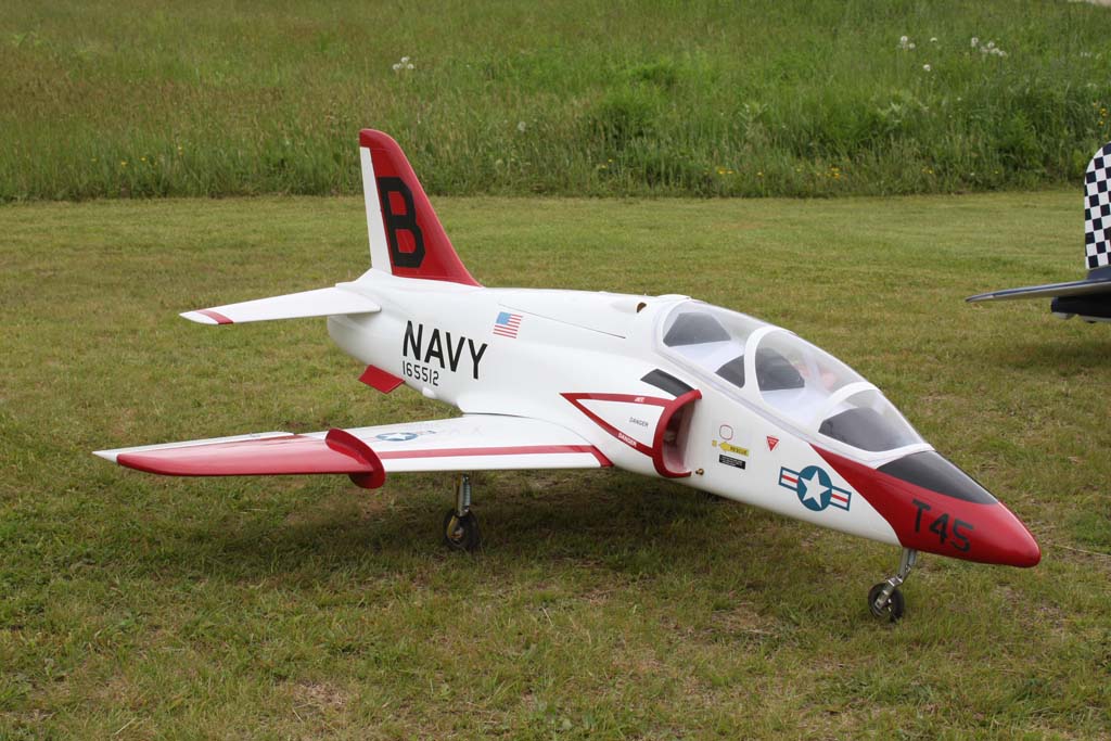

I have the same Hawk with the T-45 markings. I am using TamJets gear with breaks and a Wren 44 Gold. I have about 14 flights on it and love it. Make sure you add the wing fences. My first one did not have them and snapped on me when I was coming in a little slow. I have never seen a plane snap so quickly. I purchad the Navy T-45 decal sheet from SAPAC as they make a 100mm T-45 and the decals are the correct size for the AMD/Will Hobby T-45. I think I paid about $30 for the full set. See picture attached. Good luck with your build.
Mark

Looks good but needs a pilot badly,
Old 05-30-2011 | 05:03 PM
  #696
mmontella's Avatar
My Feedback: (36)
Joined: Jul 2005
Posts: 224
From: E. Falmouth, MA
Agree.... I had some nice pilots that were the correct scale for the plane but they did not fit as the conopy is too low.

Yes the canopy is the wrong shape scale wise it should be much more higher and dolphin like.
What I done with mine was to lower the floor by cutting out a square from the floor and made a 1" deep box out of balsa which I painted black and put my pilot/seat in.
Unfortunately I just sold mine last week, so I cant take a pic, but I have a shot through the canopy, you can just see what I done, the rear one is a bit clearer as it has no pilot just the seat.
