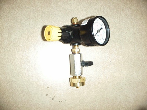

Default Regulated Propane Valves
I've been building them for some time now. Can regulate all the way down to 0 psi. Has a simple On/Off so that you don't change your regulated settings. Works great! Here's some pics.

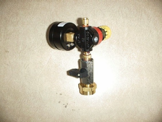

Old 09-26-2002 | 12:13 AM
Posts: 235
From: Leetonia, OH
Default Pic #3
If you are interested in purchasing these - go to the Product Announcement & Manufacturer News, that's out on the main page almost all the way to the bottom. You'll see the subject: Regulated Propane Valves. All the information with pricing is located there.

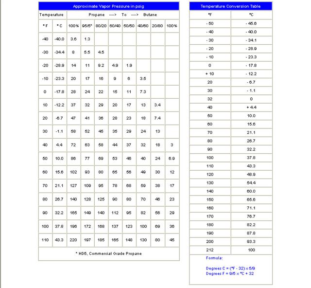

Default Propane
Pressure chart
