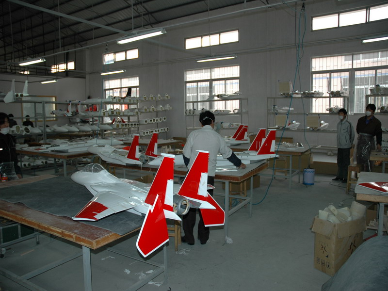

John,
I'm not sure about Ali's next shipment schedule for his container. I just left the factory last week, and it looks like there is still some more production to be finished. You might try and contact Ali (0208) 500 8884 or 8887 (UK) for the ETA. I'm sure it shouldn't be much longer. If you'd like yours right away, you can contact him to have air cargo shipped to you at a very small fee.

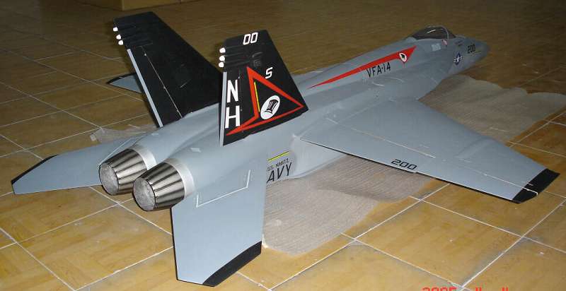

Ian,
Yes the picture you see is the black tail F-18E. That is one of the factory standard paint schemes with full rivet details. I will bring this plane to the Best in The West next week. Will you be attending the show as well? I didn't see you in Florida Jet this time, so maybe I'll see you in Cali.

Ian,

Sorry, but I've been tied up preparing for the Best in the West. I haven't had a chance til now to answer your question. The F-15B's production has been completed in the factory. The container is on its way here. We expect it to arrive at the end of this month or early next month, and should be ready for purchase. The F-15B comes with a white base primer color, Edward gel coat (red/white), or bicentennial gel coat (red/blue/white)color scheme. Although the new production has more details and is lighter than the previous version, but the rivets won't be seen on the F-15, and will only be available on the F-18E. We will see the publics reaction and see if we want to add this feature on to the rest of our product line.
