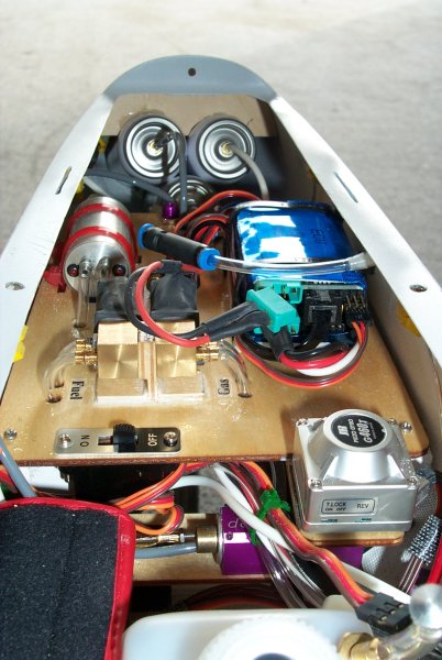

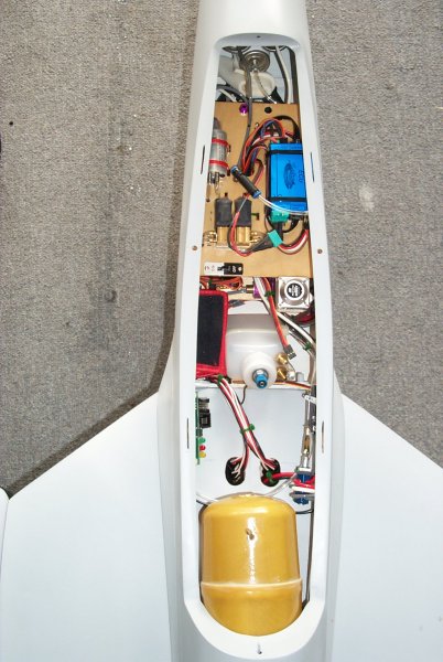

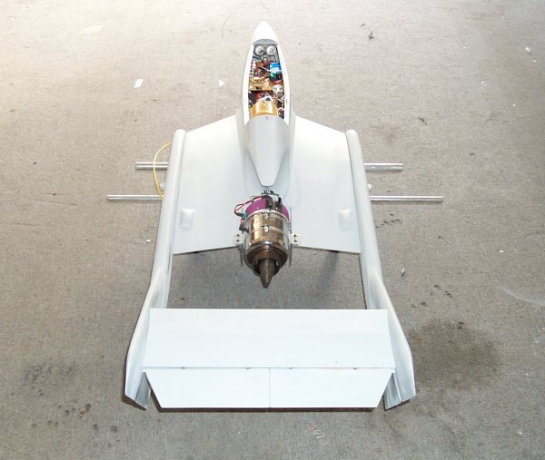

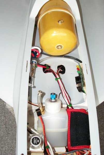

Well, the BC is just about ready for test flight this weekend (weather permitting). Still have to plumb the tanks and do some more radio programing but all the gear is in. Pics should be up on the site shortly but here are a few....

Would it be best to install the filter right at the feed line coming off the UAT to the pump? Thats what I had planned? If I am using powermax, should I still have a filter in-line from the propane tank before the valve?

The propane filter goes just befor eht shutoff valve as well. It can have any orientation and be rigidly mounted if you desire.

Wouldent you want the filter before the pump to stop any possible particles from passing through it? Think my kangaroo is set up that way, should I change this?? Why cant you rigidly mount the kero filter (just curious)?? Always learning

I'm sure opinons will vary - but my preference would be for the filter to be after the pump. That way, if the pump should for any reason shed any material, it gets caught in the filter instead of going through the engine.
That's not a bash at the quality of the pump BTW - just me being cautious. Just two weeks ago at the Reno Air Races, we had a $1000 high-spec ADI pump start shedding minute bits of plastic after only 30 minutes of use... so if this can happen with a $1000 part, it can surely happen on our relatively cheaper and lower-spec parts.

Gordon has hit it on the head, you want to catch anything coming AFTER the pump, before it can clog the shutoff valve or the turbine. The pump can pretty much take anything a UAT can offer it (you get a lot of filter action from a UAT BTW). We put the UAT into the manual, it really is a pretty much mandatory piece of equipment as far as JetCAT USA is concerned.
As for the kero filter, we believe that, incorrectly installed, the kero filter can become a sort of air trap, capturing "micro" air bubbles and thereby creating an air pocket within the filter itself. At the wrong time (of course!) the pocket gets expelled, goes into the turbine and you flame out.
So first and foremost, mount the filter vertically. That will allow these "micro" bubbles to go through the pump and on to the turbine without adverse effect.
As for not rigid mounting, if the filter is loose on the line, the natural jostling of the plane will help dislodge any micro bubbles before they get big enough to matter.
Also a loose mounted filter is easier to check for dirt and to flush as needed. Over time you will need to do that.

Per the instruction that came with my JETCAT , the filter should be in-line between the kerosene shut-off valve and the fuel pump.

I think it's a good idea to zip-tie or velcro in the main tank that sits on the wing, should you be one of those people that has there hatch pop off. It happened to me once in twenty eight flights this year.

how the heck did you loose the hatch?? Was the pin not long enough? I am using those carbon blocks BV provides to secure the tank in the hatch, did you not install them?
Todd
OOOps....just re-read your post and I think you mean the tank in the fuse not the wing.....Yes, already have made provisions to tie that tank down when I have completed plumbing them. Thanks for the input though.....

David or anyone else. How are you mounting the fuel filter?
Horizontal or vertical. Right now mine is horizontal. Should I change this to prevent a posible problem later. Leaving for Superman Monday morning. No new news on Dan's mother.
